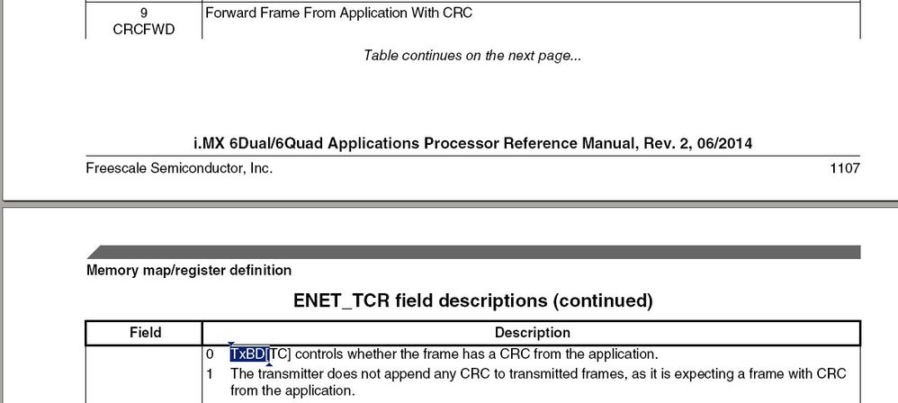

antzhao
Thanks for your answer.
But are  ENET_RACC and ENET_TACC about hardware checksum.
In Kernel,there ard some codes
/* set RX checksum */
  val = readl(fep->hwp + FEC_RACC);
  if (fep->csum_flags & FLAG_RX_CSUM_ENABLED)
  val |= FEC_RACC_OPTIONS;
  else
  val &= ~FEC_RACC_OPTIONS;
  writel(val, fep->hwp + FEC_RACC);
If
.driver_data = | FEC_QUIRK_HAS_CSUM
Rx will do checksum,But The kernel does not do checksum for Tx.
there are not any codes about TACC.
So if I want do hard checksum for Tx ,What should I do?
I set TACC[PROCHK] and TACC[IPCHK] to 1,But it does not work.
Thanks again!

igorpadykov
