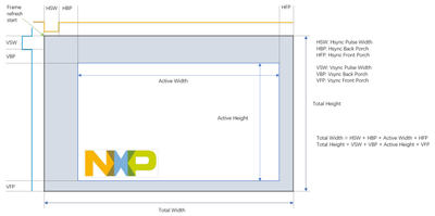

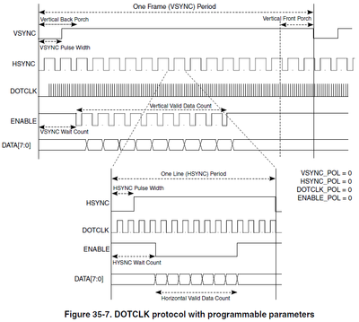

Using a single frame buffer means that all the drawings have to be done during the period of VSYNC Pulse Width (VSW).
If the drawings can’t be done before the end of VBP, the tearing will likely be observed on the screen.
Please take a look to the pictures below.
I hope this helps.
Daniel.
