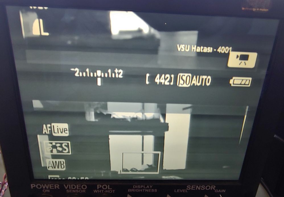

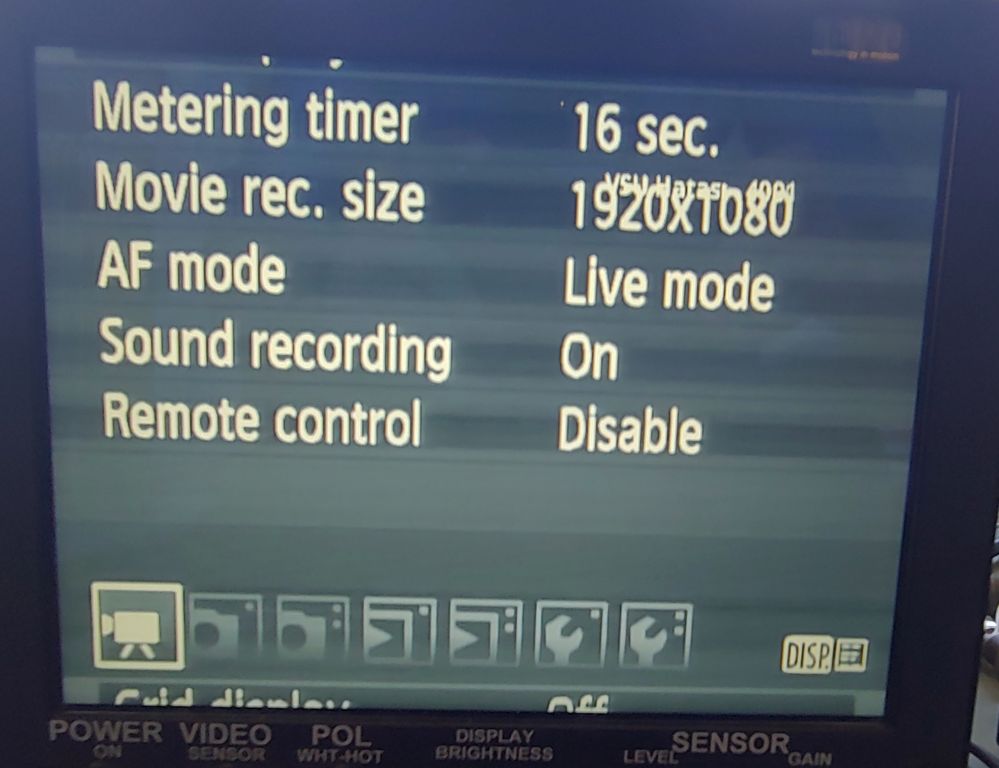

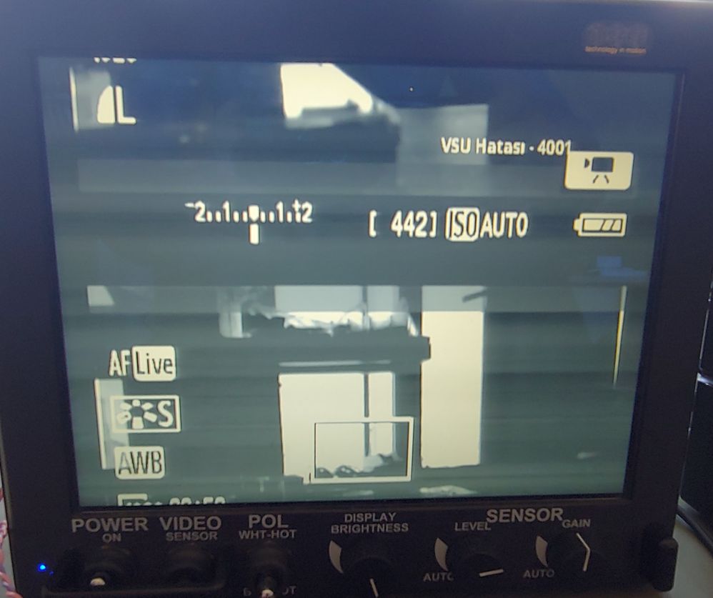

I am working on a project which is about capture video.
When the system starts(Video input enable) everything is good.  The video seems to start at top of the monitor. Everything is flawlessly but the system starts(video input disable) and then the video cable connects to the system. The video seems to start at the CUSTOM location of the monitor.  The video starts sometimes the center of the monitor, sometimes bottom of the monitor.
How can ı solve this problem?
Video input source:   NTSC
Video input decoder: ADV7180
Video input encoder: adv7391
Linux Kernel: 3.14.28
Video Shifted Down

Hi Muhammet
one can try to reset ipu channels as on below link or probably reinitialize ipu.
i.MX6DL Display lockyp with IPU_INT_STAT_10, and IPU_INT_STAT_5 errors.
