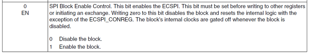

I'm using iMX6ULL EVK, I have enabled mass storage detection on USB OTG. I would like to diable ECSPI communication when USB is connected. How to do that?
Is that possible to disable a node while interfacing USB device?

Hello  mathew,
     ECSPIx_CONREG register bit "EN" is used to enable or disable eCSPI.
see page 809 of reference manual.
Have a nice day!
