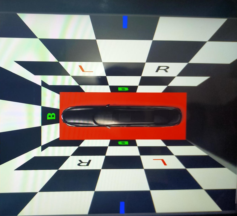

Dear All,
I working in imx8qm-mek board and use the rear_view_camera.
I got the default images by using the dumpsys commands after integrating CAN
How to disable this default view functionality ?
      RVC displayed in one of the tile at the right side of the screen.
Thanks & Regards,
VInoth S,
Vinothkumar Sekar

Hi VInoth
one can try turn on/off commands for cameras described in
sect.8.1.1 Interfaces to control the EVS function attached Android Guide.
igor

Hi igorpadykov‌
I done those configuration software side but, not working as per exception and finally, I found where the problem,
I changed GEAR_SELECTION default value to park from reverese
diff --git a/vehicle/impl/vhal_v2_0/DefaultConfig.h b/vehicle/impl/vhal_v2_0/DefaultConfig.h
index 03dd662..52fdad5 100644
--- a/vehicle/impl/vhal_v2_0/DefaultConfig.h
+++ b/vehicle/impl/vhal_v2_0/DefaultConfig.h
@@ -907,7 +907,7 @@ const ConfigDeclaration kVehicleProperties[]{
              .access = VehiclePropertyAccess::READ,
              .changeMode = VehiclePropertyChangeMode::ON_CHANGE,
-     .initialValue = {.int32Values = {toInt(VehicleGear::GEAR_REVERSE)}}},
+     .initialValue = {.int32Values = {toInt(VehicleGear::GEAR_PARK)}}},
Default gear value is reverse in simulator and I configured as park. After this I got this default image.
I don't why this makes the problem.
Thanks & Regards,
Vinoth S,
Vinothkumar Sekar

Thank you Igorpadykov for the reply.
I got some information from your input.
evs/app/EvsStateControl.cpp
mTurnSignalValue.prop = static_cast<int32_t>(VehicleProperty::TURN_SIGNAL_STATE);
source/vendor/nxp-opensource/imx/vehicle/impl/vhal_v2_0/DefaultConfig.h
-     .initialValue = {.int32Values = {toInt(VehicleTurnSignal::NONE)}}},
+     .initialValue = {.int32Values = {toInt(VehicleTurnSignal::RIGHT)}}},
I will test and update.
