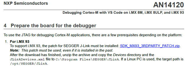

Hi @AnkitaLengare24
To use the JTAG for debugging Cortex-M applications, you need to do some prepare work, install a patch.
For details, please refer to AN14120. Download here :  Introduction

AnkitaLengare24
Hi Daniel,
As per your suggestion AN14120 I referred the document and download patches .and also paste the .xml file to the segger path after doing this steps i cant connect to tyhe debug probe . what should i do next can you guid us for the further steps .

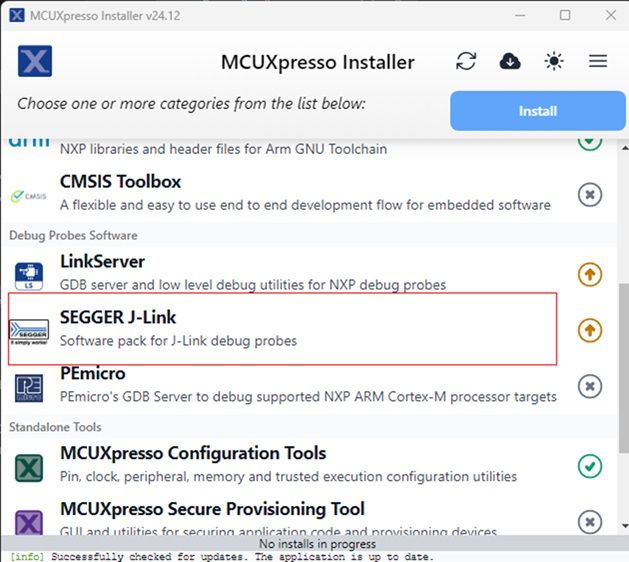

danielchen
Hi  @AnkitaLengare24
It seems you didn't install Segger Jlink,  please install it with MCUXpresso Installer.
