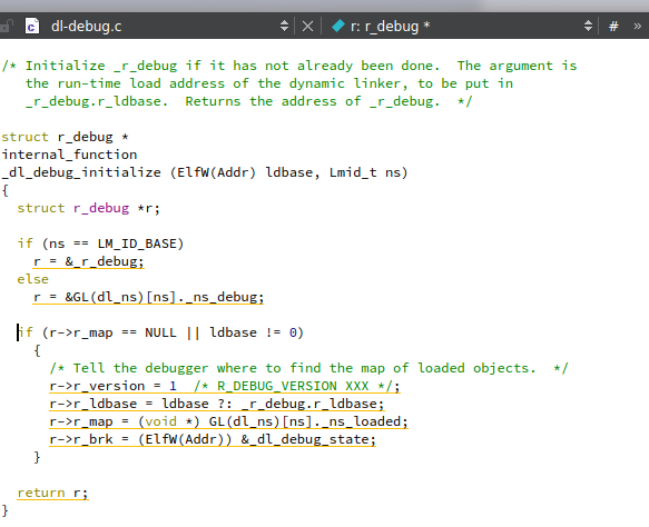

I have tried with two simple projects, one with Qt and one without Qt. For both tries, I was able to debug the application without any problems.
As an another try, I have moved the application to QtCreator IDE and built and compiled it. The debugging attempt with Qt also produces a SIGSEGV however this time I was able to see where the executable access to invalid memory. Please see the attached screenshots:
(Ps. Above the line 55 is where the cursor hangs)
After a little search on problem I have found a stackoverflow thread:
boost - Segmentation fault only during GDB debugging - Stack Overflow
Were you or any people from community faced this problem before? What is your opinion about the problem?
