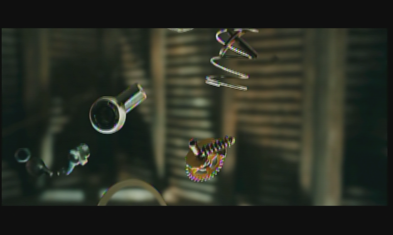

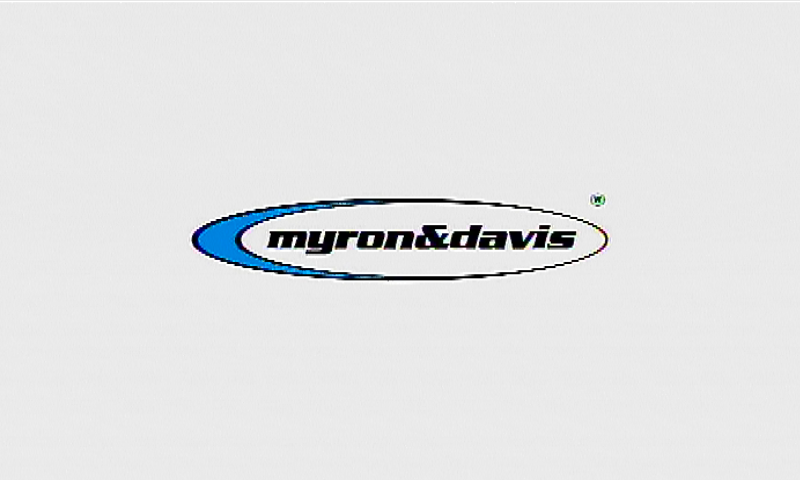

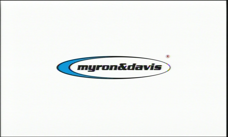

I using i.MX6DL with ADV7180.
The software platform is "android jb4.3 r1.1.0".
I found the image quality is very best when the video is static image. The show as below.
But if the video is move image. the object edge will have some interlacing artifacts in edge of motion object. The show as below.
For this issue, i adding apply patch at <De-interlace Capture Device>, the image became blur. The show as below.
Is this right? How to improve it?

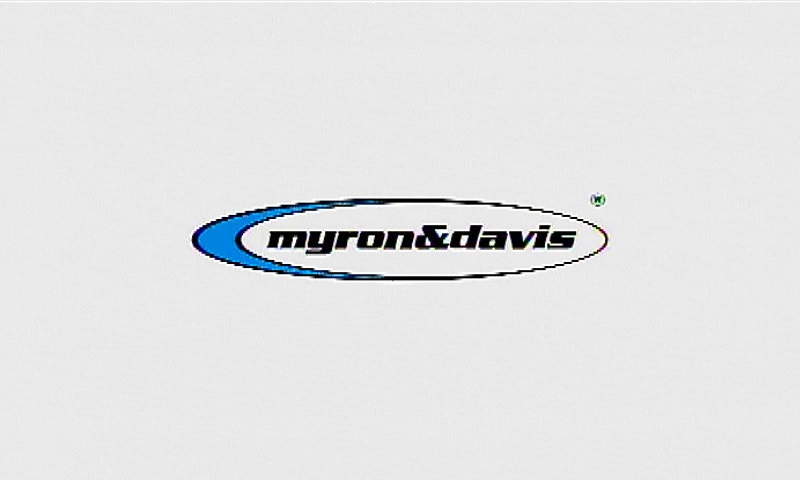

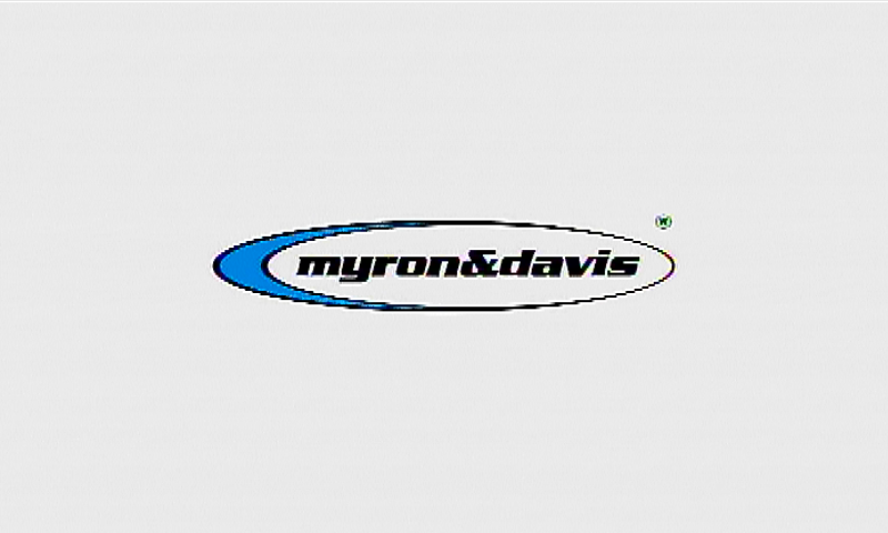

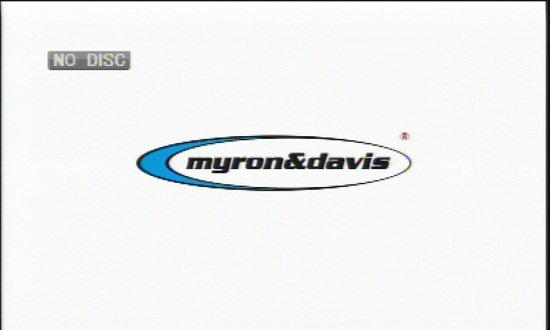

rotechen
Hello Sergio,
Thanks for your reply. I modify the file "ipu_vdi_enc.c" follow your suggest. But the issue still happen.
Below show my capture image.
1. enc.mem_prp_vf_mem.field_fmt = IPU_DEINTERLACE_FIELD_BOTTOM
2. enc.mem_prp_vf_mem.field_fmt = IPU_DEINTERLACE_FIELD_TOP
3. enc.mem_prp_vf_mem.field_fmt = V4L2_FIELD_INTERLACED_BT
4. enc.mem_prp_vf_mem.field_fmt = V4L2_FIELD_INTERLACED_TB
