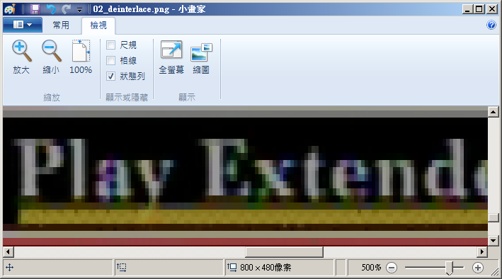

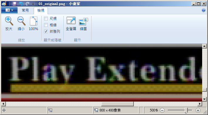

Add apply patch at <De-interlace Capture Device>, the image became blur. Is this right? How to improve it?
01_original = Freescale Android JB4.3 1.1.0
After apply deinterlance patch

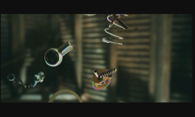

If I don't add the patch, the image will some interlacing artifacts in edge of motion object. It show as below.
If i adding apply patch at <De-interlace Capture Device>, the image became blur. How to improve it?

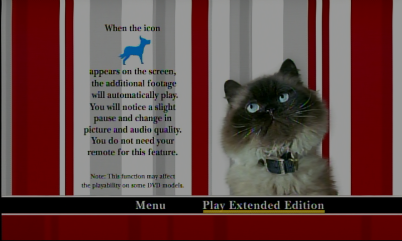

Without patch
With patch
