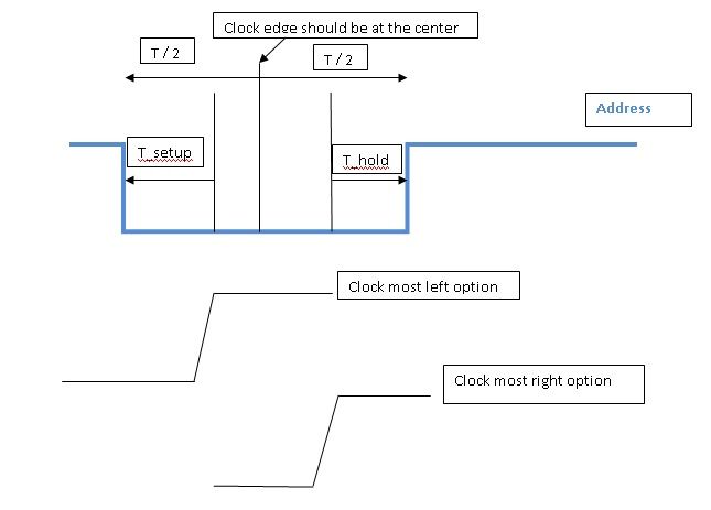

  IMX6 output DRAM address and clock signals, assuming address should be
latched at clock edge in the center of address assertion. In practice, because
of PCB trace delays, it is possible to vary clock edge position. But setup an hold
timings provide available most right and left locations of the clock edge.
When setup and hold timings are not the same, it would be preferable to
restrict clock varying for one direction.
From the recent Datasheet :
DDR6 (Address output setup time, tIS) = 500 ps
DDR7 (Address output hold time, tIH) = 400 ps
    So, basic concept is that clock and address traces should be very close each
other to avoid timing problems because of signal delays ; but we can allow
some shift to right (on the figure) for the clock, since hold time is less than
setup. 200 mils mean about 30 ps of delay (6’’ ~ 1 ns), which is 1/3 of
(tIS – tIH) – for assurance.
Yuri.

  Note, the (asymmetrical) requirements [in Table 3-3 (DDR3 routing by
byte group)], say, for signals of Address and Command group to be shorter than
the clock (min = clock-200, max = clock) relate to specifics of i.MX6 implementation
(say, for i.MX6 address setup and hold  timings are not symmetrical).
Yuri
