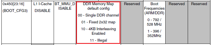

Dear Freescale team.
I have a i.mx6qsabrelite board.
need to know what is the bellow DDR Memory Map default config for setting  TZASC in the board.
becuase there are TZASC1, TZASC2 for MMDC#0, MMDC#1.
the OCOPT_CFG valuses :
     OCOTP_CFG0 : 0xDBC90E6A
     OCOTP_CFG1 : 0x251191D4
     OCOTP_CFG2 : 0x2000008F
     OCOTP_CFG3 : 0x00620302
     OCOTP_CFG4 : 0x18000030
please help me....
best regards,
mjHwang
2,569 Views
Yuri
  The BOOT_CFG3 “DDR Memory Map default config” configures startup
memory configuration. The I.MX6 MMDC supports the following modes :
* 16/32/64-bit DDR3-1066 and  LPDDR2-1066 (as  single channel, when only    MMDC0 is used ) ;
* dual 32-bits LPDDR2 (Fixed 2x32 map) ;  channel #1 via MMDC0 and    channel #2 via MMDC1 ;
* for LPDDR2 : 2x32 interleaved
The SABRE Lite is equipped with DDR3, and only single channel configuration
is used.
