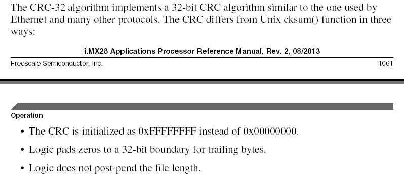

Why do I use the DCP Hash function on i.mx287 to compute the CRC32 check of the string "1234" to 0xa685c4aa, but the result I calculated using the calculator is 0x9be3e0a3? Is the algorithm different?

Hi li
it uses slightly different algorithm as described below
igor

No, he said Unix cksum() is another algorithm, I used the algorithm should be the same as the DCP, but the results are not the same.
CRC32 is X32+X26+X23+X22+X16+X12+X11+X10+X8+X7+X5+X4+X2+X1+1。

igorpadykov
seems algorithm using the calculator was different from DCP
described in Reference Manual.
Please look at DCP driver in linux-2.6.35.3/drivers/crypto/dcp.c.
~igor

Do you know how the crc algorithm of DCP is specific? Is there a documentation? If not the same, what is its application scenario?
2,929 Views
igorpadykov
sorry there is no additional documentation except provided in reference manual.
