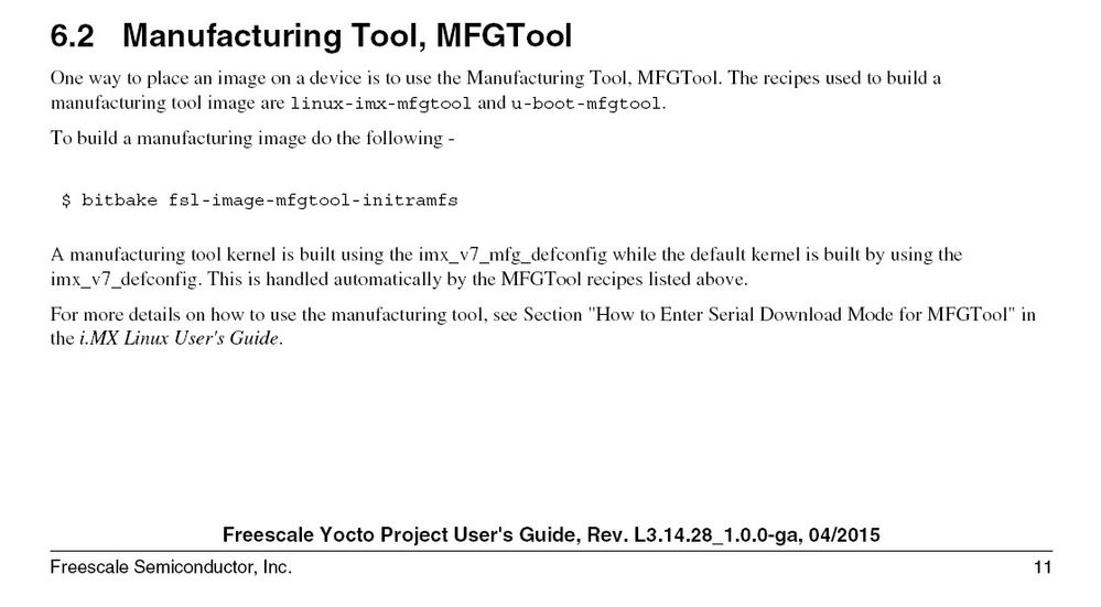

Hi All,
         We are trying to add support for MFG tool in our board. But MFGtool hangs on loading our custom uboot. It is stuck at loading uboot. How can it be resolved?

Hi Vijai
Mfg toos firmware should be rebuilt with new ddr settings for custom board
(located in uboot dcd header), they can be found from DDR test results
https://community.freescale.com/docs/DOC-96412

Hi ,
                          I have built custom firmware (uboot kernel and initramfs). But when trying to load it with MFG Tool it hangs at "Loading uBoot". It successfully loads the SABRESD uboot but not mine.

Hi Vijai
could you provide full log ? You can try to rename custom uboot to name
which is used by "SABRESD uboot" (which loads succesfully, as you mentioned)
