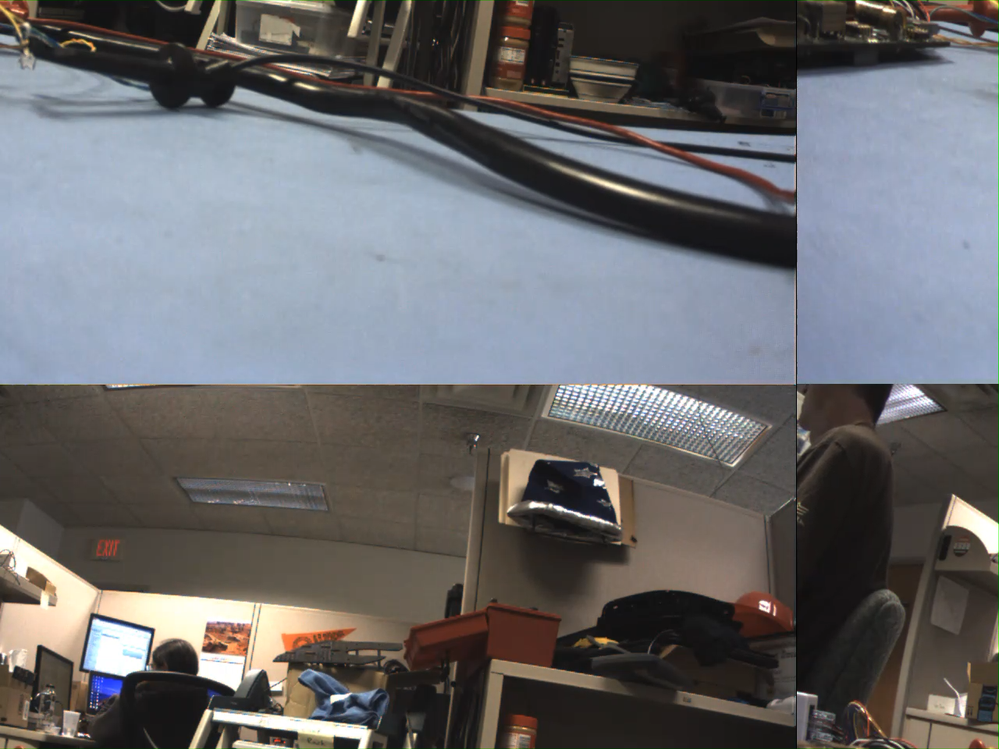

jwatts
Huge apologies for posting to a 2-year-old thread, but our use case is just about precisely the same as yours and we're having trouble with one last facet of capture: We are successfully capturing frames, but the IMX seems to be ignoring SOF and EOF packets. If there is any hiccup in reception, or if the IMX takes too long to begin receiving MIPI data, then it begins part-way through the "first" frame and delivers an un-synchronized stream. Some times we get continuous NFB4EOF errors, and sometimes we don't, but the frame offset remains constant until we stop and restart the entire capture chain. Did you ever encounter this kind of issue?
Here's an example of our capture:
