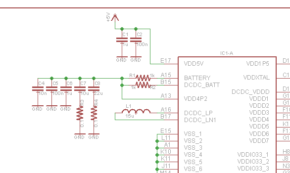

I design my own board with an imx28 CPU. I configured the board (resistors on LCD_D0 to LCD_05) to boot on SSP0 (SD card).
When I try to boot without SD card connected, I have the 0x8020a014 error code on the debug console. So it seems it want to boot on Sd card. So it's good.
But when I connect the SD card, I have absolutely nothing on the debug console.
I measured voltage and everything is good except VDD4P2. It equal to 0.8V !!!!!
This is the schematic :
Can you help me ?

In order to close this topic, please find attached my patch for VDD5V Only and the patch for my DDR2 (Samsung K4T51163QQ-BCE7).
Finaly, these patchs are very simple.
To explain what my patches do :
In spl_power_init.c, I set DROPOUT_CTRL (in HW_POWER_DCDC4P2 register) to "DcDc Converter power source is DCDC_4P2 regardless of BATTERY voltage" instead of "DcDc converter selects either VDD4P2 or BATTERY, which ever is higher."
In spl_mem_init.c, I set CS_MAP (in HW_DRAM_CTL29 register) to 1 instead of 16 (?) and I set EIGHT_BANK_MODE (in HW_DRAM_CTL31 register) to "Memory devices have 4 banks" instead of "Memory devices have 8 banks".
In mx28evk.h, I set "define PHYS_SDRAM_1_SIZE" to 0x04000000 (64MB) instead of 0x40000000 (1GB).
Now, everything is fully stable. After 200 loops of 30MB test with memtester I have 0 error. All the supply from the IMX a solid and with a correct voltage.
Many thanks for all your help during these 3 months. This is the culmination :).

graemeruss
Hi Damien,
I tried your patch, but I still cannot get the board I am working on to boot. I added some more debugging to your patch (expanded patch with your changes plus my debug output attached)
With the additional debugging, I get the following console output:
SPL: Serial Console Initialised
SPL: Initialising Power Block
SPL:   Configured for VDD 5v only (no battery)
SPL: Switching CPU clock to 24MHz XTAL
SPL: Setting auto-restart bit
SPL: Setting VDDD 25mV below DC-DC converters

dgotfroi
What's your U-boot version ?
What's the flash of your board (for u-boot) ? SD card or NAND flash ?
In my case (SD card and U-boot 2013, 2014 or 2015), the following line was needed in mxs_power_clock2pll():
clrbits_le32(&clkctrl_regs->hw_clkctrl_clkseq, CLKCTRL_CLKSEQ_BYPASS_CPU);
But try, to remove theses lines, your mxs_power_clock2pll must be like this :
static void mxs_power_clock2pll(void)
  struct mxs_clkctrl_regs *clkctrl_regs =
  (struct mxs_clkctrl_regs *)MXS_CLKCTRL_BASE;
  setbits_le32(&clkctrl_regs->hw_clkctrl_pll0ctrl0,
  CLKCTRL_PLL0CTRL0_POWER);
  early_delay(100);
  setbits_le32(&clkctrl_regs->hw_clkctrl_clkseq,
Finally, be sure that your power supply can delivrer enought current. Look your 5V with a scope.
9,406件の閲覧回数

dgotfroi
Yes. Before my patch, in any case CLKCTRL_CLKSEQ_BYPASS_CPU was set. But I saw in LTIB code that CLKCTRL_CLKSEQ_BYPASS_CPU was cleared and not set (and it worked with LTIB), so I added this line and after that my board booted. But I never tested with JTAG (I only tested with SD Card and USB OTG). So maybe it cause a failure during a JTAG boot.

dgotfroi
Perfect, it's great to hear. 1). It's not so easy. In my case, with SD card, I need to clear this bit rather than set. It depend on the way the board is used. 2). I don't know what is this define, I think this flag is define in an other file. It was already there in the original source code. 3). Yes of course you can, I'm not familiar with that. So please, you can submit it. I will try to edit my code and set CLKCTRL_CLKSEQ_BYPASS_CPU rather than clear. Maybe I miss something in my previsous tests.

dgotfroi
Thanks for your comment, you were totally right.
I removed my change in mxs_power_clock2pll(), so this is what I have now :
                early_delay(100);
And everythings works fine.
So you can delete this section of the patch.
Many thanks

[    7.597081] r3 : 8333ef00  r2 : 60000093  r1 : 00001000  r0 : c009f4c4
[    7.603625] Flags: nzCv  IRQs off  FIQs on  Mode SVC_32  ISA ARM  Segment user
[    7.610862] Control: 0005317f  Table: 42e4c000  DAC: 00000015
[    7.616623] Process modprobe (pid: 74, stack limit = 0xc2e5a1c0)
[    7.622646] Stack: (0xc2e5bde8 to 0xc2e5c000)
[    7.627034] bde0:                   c3fec060 c004207c c06e21bc c00a01e8 00000001 c3fec060
[    7.635240] be00: 00000001 c3fec040 00000000 00000001 00000000 c009f4c4 00000000 c3fec040
[    7.643446] be20: c3f7c000 00000000 00080208 00040000 c06e5408 c06e5408 c06e21bc c00a11c8
[    7.651651] be40: 00000000 c3fd8b00 c3fec040 00000000 c2e5be74 c2e5be88 c06e5408 c00a132c
[    7.659856] be60: c3fd8b00 000000a1 00000000 00000007 c2e6f520 c06e21bc 00000007 c00a56e8
[    7.668062] be80: c2e5bf00 00000000 c3fd8b14 c3fec054 c2e82268 c2e6f524 c3fd8b00 c2e6f524
[    7.676268] bea0: 00000007 00000007 0000001c c2e6f508 c2e22654 c00cd270 c2e82630 c2e5bf00
[    7.684473] bec0: c2e22600 00000001 00000001 c2e5a008 c2e22600 c00c440c c2e22600 00000001
[    7.692678] bee0: 00000000 00000000 ffffffff 00000000 00000000 00000149 00000400 c2e6f000
[    7.700884] bf00: c2e5a018 00000001 60000013 c0e94d1c c2e22654 c2e22600 00000000 c37dd420
[    7.709088] bf20: 000000f8 c2e22600 00000000 c37dd420 000000f8 c0014588 00000001 c377f21c
[    7.717295] bf40: c377ef00 c00178e8 00000002 00000000 c3707ad8 c2e575a8 b6f70000 c00dafc4
[    7.725500] bf60: 00000000 00000100 c2e5a000 c37dd420 000000f8 c0009724 c2e5a000 00000000
[    7.733704] bf80: 00000000 c0018f98 ffffffff 00000001 00000001 452d5b50 000000f8 c001901c
[    7.741910] bfa0: ffffffff c0009560 00000001 00000001 00000001 452d84c8 00000001 ffffffff
[    7.750114] bfc0: 00000001 00000001 452d5b50 000000f8 452d84c8 00000000 00000000 00000000
[    7.758319] bfe0: 00000000 beab5a30 451d2b20 4523f370 60000010 00000001 fbffffff efdffdf3
[    7.766557] [<c003fa34>] (trace_hardirqs_off_caller) from [<c004207c>] (debug_check_no_locks_freed+0x48/0x160)
[    7.776608] [<c004207c>] (debug_check_no_locks_freed) from [<c009f4c4>] (free_pages_prepare+0x144/0x19c)
[    7.786134] [<c009f4c4>] (free_pages_prepare) from [<c00a11c8>] (free_hot_cold_page+0x28/0x150)
[    7.794875] [<c00a11c8>] (free_hot_cold_page) from [<c00a132c>] (free_hot_cold_page_list+0x3c/0x9c)
[    7.803966] [<c00a132c>] (free_hot_cold_page_list) from [<c00a56e8>] (release_pages+0x220/0x238)
[    7.812796] [<c00a56e8>] (release_pages) from [<c00cd270>] (free_pages_and_swap_cache+0xac/0xc4)
[    7.821630] [<c00cd270>] (free_pages_and_swap_cache) from [<c00c440c>] (exit_mmap+0x128/0x20c)
[    7.830295] [<c00c440c>] (exit_mmap) from [<c0014588>] (mmput+0x40/0xdc)
[    7.837046] [<c0014588>] (mmput) from [<c00178e8>] (do_exit+0x24c/0x8f0)
[    7.843795] [<c00178e8>] (do_exit) from [<c0018f98>] (do_group_exit+0x3c/0xb0)
[    7.851062] [<c0018f98>] (do_group_exit) from [<c001901c>] (__wake_up_parent+0x0/0x18)
[    7.859013] Code: 1a000002 e10f2000 e3120080 0a00000b (e5932380)
[    7.865142] ---[ end trace f0433865ddbd6572 ]---
[    7.869778] Fixing recursive fault but reboot is needed!
bootlogd: cannot allocate pseudo tty: No such file or directory
[   10.869348] random: nonblocking pool is initialized
Do you have any idea ?
9,405件の閲覧回数
fabio_estevam
Looks like your DDR settings are not stable yet. If you boot the board several times: does the crash look always the same or does it change every time?
