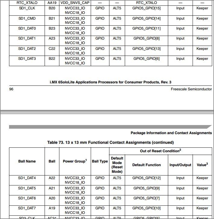

We're using 6sl of the MCIMX6L8DVN10AB package type. I'm looking through the pad list and SD1_CD is not listed. http://www.nxp.com/docs/pcn_attachments/16116_IMX6SLCEC.pdf
The pad list for SD1 for this package only shows:
From 6slrm, I can see SD1_CD signal can be sourced from the following pads: ECSPI2_SS0, FEC_TXD1, KEY_COL0, KEY_ROW7 but which pad is the one that boot ROM will use?

igorpadykov
Hi Jaya
ROM uses KEY_ROW7.alt6 as shown in Table 8-14. SD/MMC IOMUX Pin Configuration i.MX6SL RM
