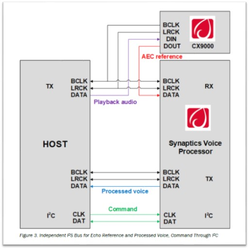

I'm working on IMX8M Mini EVK with Android Pie (p9.0.0_2.3.0) OS.

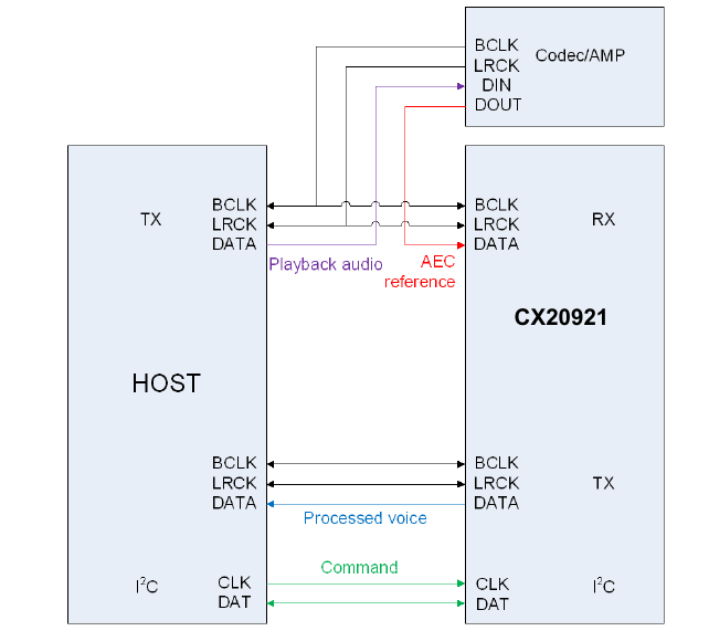

I have integrated CX9000 synaptics audio amplifier and CX20921 Dual MIC voice processor to the EVK.
There are two DMICs connected on the CX20921, one for capturing left channel data and other for capturing the right channel data. A 10W speaker is connected on the CX9000 speaker amplifier.
The connection between NXP processor, CX9000 and CX20921 are as shown in below diagram.
The CX9000 and CX20291 are detected successfully on the EVK. I am also able to play and record audio on the device using tinycap and tinyplay commands.

Hello namanthaker,
From the table#3, the playback clock is provided by Host, the capture clock is provided by CX20921.
From the below image, the playback clock is provided by CX9000, the capture clock is hard to say provided by whom.
I don't know which one is the correct one.
From my experience, to make AEC work, capture and playback clocks need to be synced. But in either case, it can not be ensured that the clocks are synced. The best way to be sure is to measure the clock signal while running VoIP...

1.       NXP Host side issue probability reason :

3.       B CLK & WS_CLK summary for setup:

Table#3
Summary :
1.     As per above Table#1, ROW #1, 2, 3, 4   && Tabel#2, Row#1, 2, 3, 4
It has been evident that noise is present when Synaptic chip AEC feature has been used
2.    However when we compare Tabel#1: ROW#1 & 5, NXP host side issue probability is evident
Please note that Qualcomm based board setup and NXP host based setup has used same Synaptic unit (HW, Firmware and all setting including test environment used, refer below Table#3 for details)
Infect recording using tinycap as well as VoIP call has very good Quality with long range.
3.     Due to lockdown we can’t check these clock, whether they are very perfect with more calibrated CROs without going to office labs
To confirm whether the QCOM Vs NXP host provided clocks are perfectly same (i.e. glitches or noise free or not).
Hence does your team can share experience, whether NXP i.MX8M Mini chipset checked/ used with any other ODM with any external Audio CODEC based on I2S data and I2C programming Like Synaptic is being used in our case (Connection being show below, where Voice processor is CX20921).
Indeed, Once we hear inputs from Synaptic, we will let you know the result with AEC disabled.
Meantime can you please check above points.

sureshrao
Hello namanthaker,

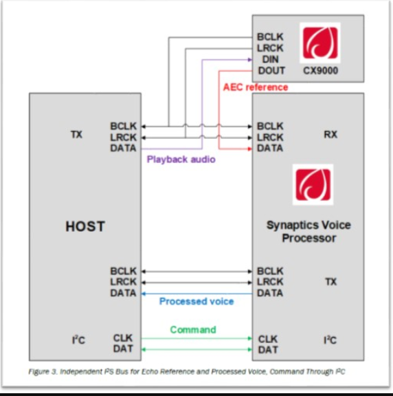

namanthaker
Hello Suresh,
Thank you for the continued support!
We successfully managed to remove the continuous noise in the VoIP call. As per your suggestion regarding clock synchronisation, we made changes in the kernel, to use i.MX8MM as master and configured CX20921 in slave mode.
Previous Configurations:
IMX8 as Master and CX9000 as Slave
IMX8 as Slave and CX20291 as Master
New Configurations:
IMX8 as Master and CX20291 as Slave
We have below queries based on the issue:
Q1. What could be the reason for the noise to be absent when IMX8MM is made master and CX20921 is used in slave mode ? Because, such issue is not observed when in Qualcomm EVM which has the same configurations as our previous configurations i.e. CX20921 as master.
Q2. In our system, we are using 2 individual I2S master for CX20921 and CX9000 respectively. But we plan to connect a single I2S from i.MX8 to both CX20921 and CX9000 with i.MX8 as master. Do you see any issues/ problems or challenges that may arise while using the same I2S ? Are there any restrictions in using the same I2S on IMX8MM?
Naman

Hello namanthaker‌,
For Q1, the reason is also unclear to me.
For Q2, There are no restrictions in using the same I2S. One need to ensure I2S modes and parameters set in CPU side should align to CX20921 firmware.
Suresh
