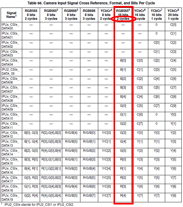

I want to connect lvds dual channel input (upto 1920x1080 60Hz) with i.MX6.
And I am going to use lvds to rgb converter chip (lvds to rgb 24bit [r8 + g8 + b8 + vsync + hsync +clk]).
Question
1. Which port do I connect rgb-24 signal on iMX6.
     1. ipu-disp0-dat[0-23] : Is this port display only?
     2. csi x : rgb565
     3 Any other port do you know or recommend?
2. Do you have any other idea?
Please let me know How to interface lvds input.

According to Table 66.
1.
There is RGB565 16bits 2 Cycle. (in Red rectangle)
Why is it 2 Cycle, Maybe miss-print?
I could be 1 cycle is correct.

lvds can not be inputted to i.MX6 processor.
I.MX6 processor has only lvds output (LDB module).

igorpadykov
Hi beomseok
RGB can be inputted using CSI, please check
Table 66 "Camera Input Signal Cross Reference, Format, and Bits Per Cycle"
i.MX6DQ Datasheet (rev.3, 2/2014)
http://cache.freescale.com/files/32bit/doc/data_sheet/IMX6DQCEC.pdf
