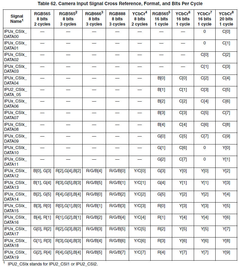

Hi Support team,
I want to connect 2x camera (12 bit bayer) to iMX6 processor. In the reference manual, Table 37-2 (Data Formats Supported By The Camera Port) comments only about 9-10 bit/value and 16 bit/value.
In order to connect a 12-bit  camera output, Can I use the following hardware connection
IPUx_CSIx_DATA08 ----> CAM_DATA_0,
IPUx_CSIx_DATA09 ----> CAM_DATA_1,
IPUx_CSIx_DATA10 ---> CAM_DATA_2,
IPUx_CSIx_DATA11 ----> CAM_DATA_3,
IPUx_CSIx_DATA12 ----> CAM_DATA_4,
IPUx_CSIx_DATA13 ----> CAM_DATA_5,
IPUx_CSIx_DATA14 ----> CAM_DATA_6,
IPUx_CSIx_DATA15 ----> CAM_DATA_7,
IPUx_CSIx_DATA16 ----> CAM_DATA_8,
IPUx_CSIx_DATA17 ----> CAM_DATA_9,
IPUx_CSIx_DATA18 ----> CAM_DATA_10,
IPUx_CSIx_DATA19 ----> CAM_DATA_11,
IPUx_CSIx_DATA20 ----> CAM_DATA_12,
and other signal HSYNC , VSYNC, PCLK, MCLK to the IMX6?
Can I use the rest of the signal associated with the camera interface (IPUx_CSIx_DATA00 to IPUx_CSIx_DATA07) for alternate function?

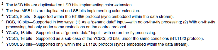

     You should know signal definitions of your camera, which lines are for Y or C, or which lines are for R, G, B. then determine how to connect them to CPU side.
     you camera is 12 bit, so you will have to connect it to CPU via 16bit connections.

I have already look at this table in the datasheet/reference manual. It doesn't provide me with enough information in order to proceed with the h/w design. Can you please recheck for the requested information.

    please refer to description in datasheet!
