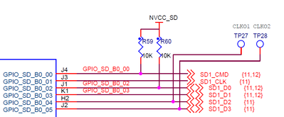

Hi Community,
I have successfully generated a pair of complementary PWM using PWM1 submodule 0, but I cannot disable PWM output  through setting the OUTEN register. It always high after I setting the OUTEN for PWMA, even I setting the GPIO to internal pull-down. This submodule use GPIO_SD_B0_00 and GPIO_SD_B0_01 to output PWM, and for GPIO_SD_B0_00, it has an external pull-up resistor. And I also try to use submodule2(GPIO_SD_B0_04&05), it works, but these pins connect to TP27 and 28, it not easy to connect to other device, so I want to know how to disable submodule0 successfully.
Btw, I'm using RT1064 EVK.

You are correct, the way to disable the submodules is with Output Enable Register (OUTEN), what you need to do is remove the pull-up resistors.
Hope it helps you.

Thanks for you reply! And I want to confirm that is there other way to make it output low level when disable the pwm module. Can I use fault pins or force out function or use other low frequency pwm to have a trigger? I feel confused! Thank you!
