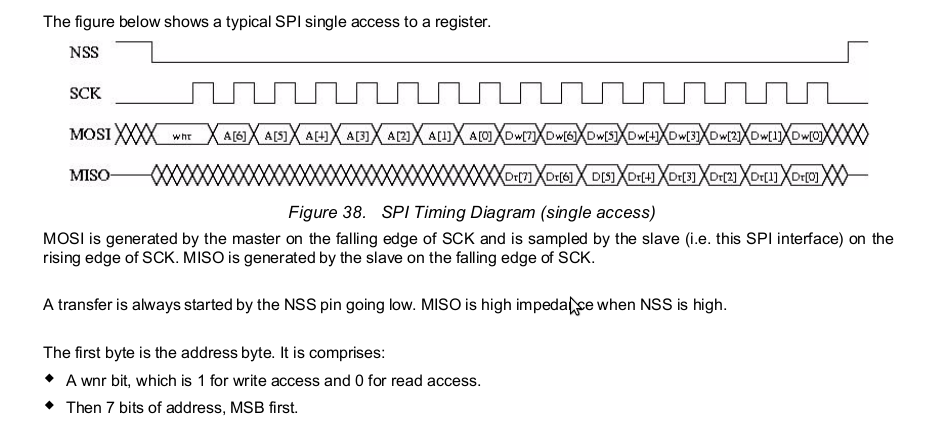

We are working on a device connected to ecspi3 interface of imx7d sabre sd board. We tried to read the chip version from the module but the transaction always returns zero. After debugging the we found that chip select(NSS) should be held down for 16 clock cycles in order to read data from the module but in imx7 the chip select line becomes high after transferring 8 bits. Attached the image of SPI transaction expected by our device,Untitled.png
To avoid this we configured chip select as gpio and tried to control it manually from our driver code. But with this method we are not receiving any clock from the master. Here is our device tree entry.

Hi Koil
using "cs-gpios" in dts, kernel configures ecspi chip select as gpio,
for holding chip select for 16 clock cycles one can try to configure
field BURST_LENGTH register ECSPIx_CONREG, described in
sect.10.1.7.3 Control Register (ECSPIx_CONREG) i.MX7D Reference Manual
http://cache.nxp.com/files/32bit/doc/ref_manual/IMX7DRM.pdf
Linux spi driver is described in sect.4.4 Enhanced Configurable Serial Peripheral Interface
(ECSPI) attached Linux Manual.
igor
