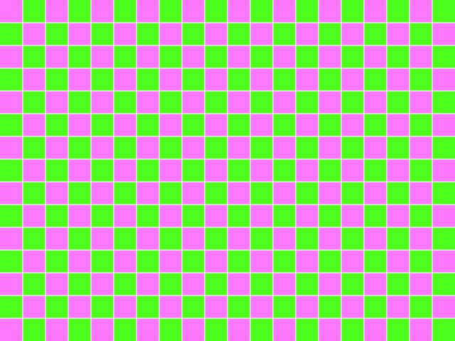

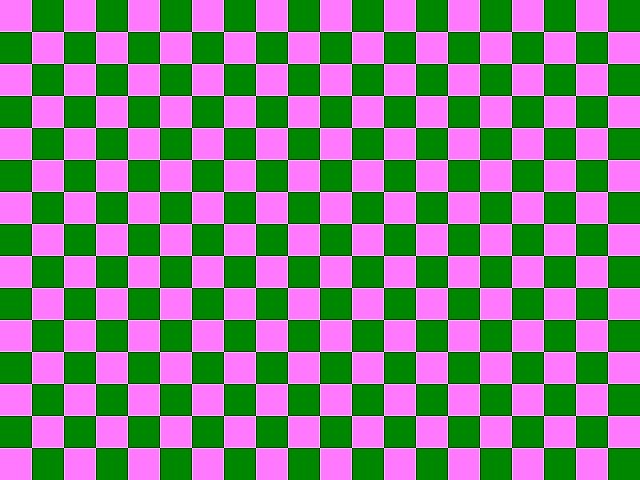

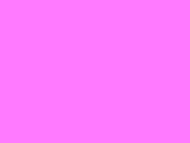

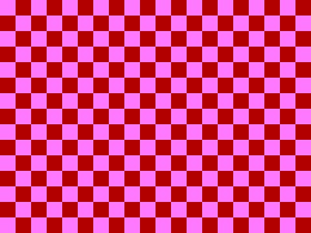

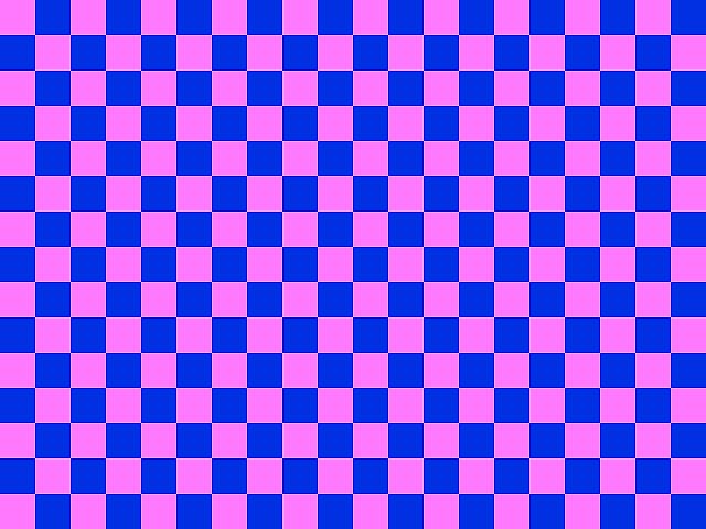

I am trying to setup CSI to generate test image (the checkboard pattern) and capture it using Gstreamer.
I am using Kernel 3.10.17 on i.MX6DL. The reference document I am using is Freescale's "i.MX 6 BSP Porting Guide"  section "7.1.3 Configuring the CSI Unit in Test Mode".
What I have done so far in kernel (mostly based on the reference document):
    1. Enabled CSI related modules in kernel menuconfig under Device Drivers > Multimedia > V4L2
    2. Modified ov5640.c driver to remove codes related to I2C and regulators
    3. Modified ov5640.c to set the sensor format from YUYV to RGB565 (ov5640_data.pix.pixelformat = V4L2_PIX_FMT_RGB565)
    4. Modified ipu_capture.c to setup CSI in CST_TEST mode. The diff is attached.
    5. Changed all IPU_PIX_FMT_UYVY to IPU_PIX_FMT_RGB565 in ipu_bg_overlay_sdc.c (didn't have any effect though)
    6. Changed "CSI IC MEM" to "CSI MEM" in struct mxc_capture_inputs inside mxc_v4l2_capture.c
After these modifications, I can capture the checkboard pattern using GStreamer:
gst-launch mfw_v4lsrc num-buffers=1 !  jpegenc ! filesink location=sample.jpg
The color format of captured images is not correct. I have attached some samples for different RGB value settings.
Is there anything I am missing in the settings that causes this issue?
RGB=(0,0,0)RGB=(255,0,0)RGB=(0,255,0)
RGB=(0,0,255)RGB=(255,255,255)
35563_35563.jpg0,0,0.jpg35750_35750.jpg255,0,0.jpg35751_35751.jpg0,255,0.jpg35752_35752.jpg0,0,255.jpg35753_35753.jpeg255,255,255.jpeg

weidong_sun
Hi Issac,
    For RGB565 data, you should capture it by GENERIC mode .
    please refter to this link !
https://community.freescale.com/docs/DOC-97981
