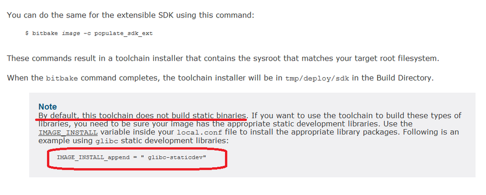

If you have read the Yocto document, you willl find
Yocto Project Mega-Manual
10,612 Views
ivyliu
Hi Biyong,
Thank you for your reply.
I have tried as the document mentioned.
But it did not work.
meta-toolchain does not have populate_sdk_ext.
Thanks and Best Regards,
Ivy
