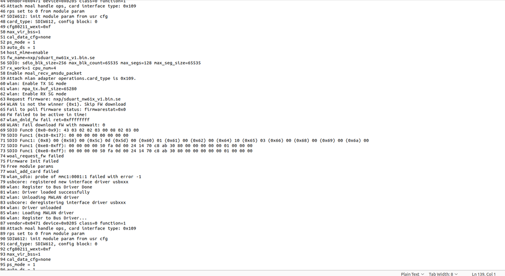

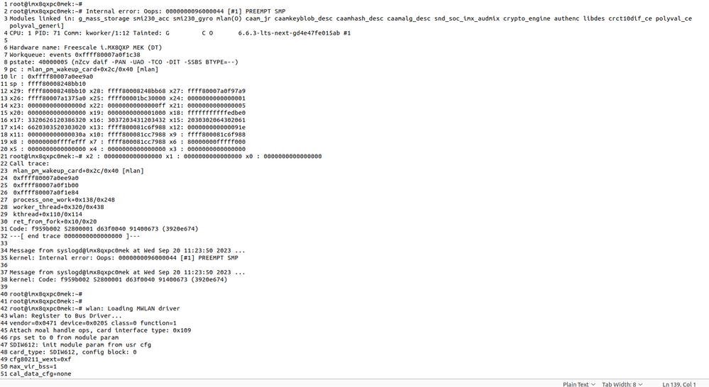

Ram2
Hi @weidong_sun
Thanks for reply
Just wanted to inform that I have followed as you informed
Cloned separetely driver and generated driver .ko files and replaced in target
when I reboot I see kernel panic I m not sure why its is can you please help me with flow to proceed furtherwifi-crash-logs-1.pngwifi-crash-3.pngwifi-crash-2.png
Do you see any dependecny
1. My work around was just generatred .ko files first and instead of building in yocto
2. First I have done scp to target to replaced with latest .ko files
i.e under cp -rf moal.ko /usr/lib/modules/6.6.3-lts-next-gd4e47fe015ab/updates/
                cp -rf mlan.ko /usr/lib/modules/6.6.3-lts-next-gd4e47fe015ab/updates/
Please find the logs pasted
