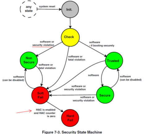

The following shows the operational states from Security Ref. Manual (Section 1.3)
 If not serviced, the TZ WDOG security violation alarm goes to the SNVS.

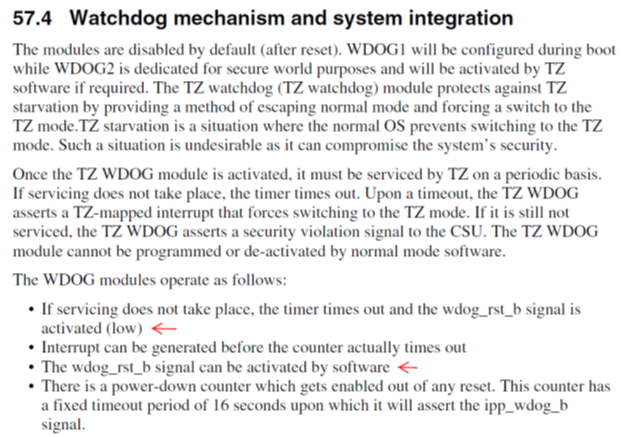

Not certain if these States match the wording from the standard Reference Manual regarding TZ Wdog as follows:
The first Red Arrow indicates that wdog_rst_b is "Activated" but the second arrow indicates that it is Activated by software.
Question 2-4:  Please clarify how wdog_rst_b is Activated (is software involved?)?
Can TZ Wdog only be mapped to external WDOG2_b?
Am I guaranteed that Reset (both internal and external reset) will happen due to TZ WDOG expiration and that it cannot be circumvented?

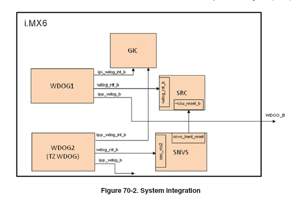

I found this diagram under Post 653405, but I don’t see anything similar under i.MX6UL.
Question 5:  Is this a valid dwg. for the i.MX6UL?

1.
  IMX 6UL supports three watchdog timers (WDOG1/2/3).
Table 57-1 (WDOG External Signals) of i.MX 6UltraLite Reference Manual (RM),
Rev. 1, 04/2016, shows three separate sets of watchdog signals. Because of
pin multiplexing it is possible to select different pins for each of the three
 watchdogs. But, say, TZ WDOG cab be mapped only to its external WDOG2 pin.
2.
  Watchdog (time-out) events may be causes both either (hardware) timer one
or software, clearing bit SRS (Software Reset Signal) in WDOGx_WCR register.
3.
  Use section 57.6 (Initialization) of the RM how to use the WDOGs.
4.
  Register SRC Control Register (SRC_SCR) may be used to mask WDOG1/3 core resets,
but the TZ WDOG(2) cannot be masked. Also, the TZ WDOG module cannot be programmed
or deactivated by a normal mode SW.
 Let me remind the Watch Dog Timer supports two comparison points
during each counting period. Each of the comparison points is configurable to evoke
an interrupt to the ARM core, and a second point evokes an external event on
the WDOG line.
5.
  The figure, showing i.MX6 WDOG is applied to i.MX 6UL in general, take into account
three WDOGs of i.MX 6UL.
