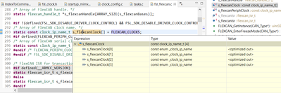

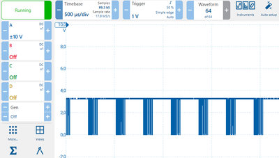

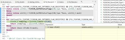

After adjusting clock the CAN Initialisation is done and I am transmitting CAN messages but the IFLAG1 is not set and it is transmitting continously.
CAN Tx signal:
but the IFLAG is not set, so its looping and continously transmitting.
I also see this, is it MCUxpresso problem or debugger?
 the macro is defined but some how the line is skipped I could not understand but the pheriperal clock has value defined.
