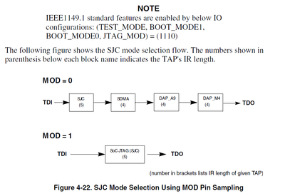

I have an i.MX 8M Mini on a custom CCA that I have been trying to debug via the JTAG port with no luck so far. I've probably read the "System Debug" section of the reference manual about 10 times and I must be missing something.
I have BOOT_MODE0 and BOOT_MODE1 pulled high, I have TEST_MODE pulled high. When JTAG_MOD is pulled low, there is some degree of communication, and I can do some boundary scanning commands, but the chain is too short. I can only talk to the SJC module (IR length = 5, DR length = 453). Also, in this mode, I always get the DFT_TAP ID 0x1cf80553.
When JTAG_MOD is pulled high, there is no communication and I'm only getting 1's clocked out on TDO.
I've also tried changing BOOT_MODE to low and TEST_MODE to low, but that isn't helping me either. I'm feeling pretty stumped.
I don't think any fuses disabling debug access have been set, but I'm happy to double-check that if someone knows of a specific fuse setting that could cause this behavior.
So, does anyone have any advice on how I can see the entire JTAG chain, access the DAPs, and make progress on enabling JTAG debug?

Update: I've discovered that setting the Instruction Register to 0x05 causes a new 32 bit number to be output from the Data Register. I don't know what this 32-bit number is (it's different from the ID code you get when IR is set to 0x04), and I can't figure out how to change the number at all.
I'm still hoping someone who has experience with JTAG debugging can help point me in the right direction.

Right now I'm using OpenOCD software with an XDS110 debugger from TI.
Can you confirm what TEST_MODE, BOOT_MODE0, BOOT_MODE1, and JTAG_MOD should be set to in order to enable JTAG debugging? Is it the same settings as boundary scan mode?
Also, can you confirm if JTAG_TRSTB is internally connected? The reference manual has diagrams that show it being used, but the hardware design guide says for that signal: "No connection from JTAG to processor". Also, JTAG_TRSTB is disconnected on the eval board JTAG header.
