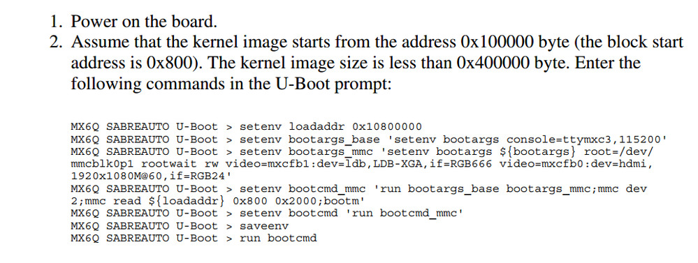

At this point there is no response at all on the debug board or indication the LCD screen that something is happening.
I am able to boot from an SD card that contains Android and Windows Embedded Compact 7 on the same board.  This leads me to believe that the way the the SD card is written (MBR, partitions, etc...) is incorrect and the board cannot boot from this SD card.
What could be wrong with the procedure of programming the SD card?

1.
Under items 4) and 5) – looks like – “u-boot-mx6dl-sabreauto.bin” is rewritten
by uImage, assuming uImage size if greater than (512 x 2) bytes.
So, please try at first to write and boot only U-boot.

Yuri, thanks for your feedback.  Finally, got something working.
I tried just programming u-boot using the following command:
user_name@computer:~$ sudo dd if=/home/user_name/Downloads/L3.0.35_4.1.0_130816_images_MX6/u-boot-mx6q-sabreauto.bin of=/dev/sdb bs=512 seek=2 conv=fsync

I was able to boot up and uboot showed it was trying to get an image using TFTP.
Therefore, in the terminal executed the following commands (used LVDS0 for the display):
setenv loadaddr 0x10800000
setenv bootargs_base 'setenv bootargs console=ttymxc0,115200'
setenv bootargs_mmc 'setenv bootargs ${bootargs} root=/dev/mmcblk1p1 rootwait rw video=mxcfb0:dev=ldb,LDB-XGA,if=RGB666'
setenv bootcmd_mmc 'run bootargs_base bootargs_mmc;mmc dev 2;mmc read ${loadaddr} 0x800 0x2000;bootm'
setenv bootcmd 'run bootcmd_mmc'
saveenv
run bootcmd
This made the LCD show the BusyBox GUI which was great.
