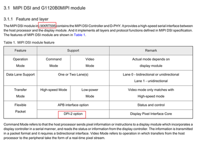

mintisan
hi,
I read AN13509-Analysis of screen pushing scene based on i.MXRT595 MIPI DSI Controller, which shows it support DPI-2 as below:
Do I missed something? Thanks...
4,348 Views
Bio_TICFSL
I mean we do not have any code for DPI-2.

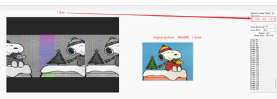

I find evkmimxrt595_lcdif_rgb565 example use lcdif(dpi)+dsi with 2 lane. It works fine.
But when I modify 2 lane to 1 lane.
The parameter not same between setting and captured:
The images shows  abnormal as below:
Should I also change clk or something else?
