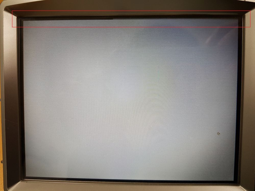

I'm using the i.MX6DL with ccd camera.
This ccd camera working well with S3C2440.
So, I connected this ccd camera with i.MX6DL and setting several things and I can see the camera video to my lcd.
It working well as S3C2440, but, when I looking the video in detail,
it has strange line in top.
and it has nosie.d
(Attacehd picture has filcker. Anyway noise is not a serious level, but it does exist.)
How can I adjust this noise level and using full lcd with this camera?
I can not get a sense of what source to test with.
Should I check the h/w structure first??
I think that this problem is depend on some source code setting.. But I can't be sure.
Below is what I using for test. ( I attached source code file also.)
Actually I change some values in this sources, but no lucks.

fb.flags = V4L2_FBUF_FLAG_OVERLAY;
ioctl(fd_output_v4l, VIDIOC_S_FBUF, &fb);
memset(&fmt, 0, sizeof(fmt));
fmt.type = V4L2_BUF_TYPE_VIDEO_OUTPUT;
fmt.fmt.pix.width= g_in_width;
fmt.fmt.pix.height= g_in_height;
fmt.fmt.pix.pixelformat = g_fmt;
fmt.fmt.pix.bytesperline = g_in_width;
fmt.fmt.pix.priv = 0;
fmt.fmt.pix.sizeimage = 0;
if (g_tb)
fmt.fmt.pix.field = V4L2_FIELD_INTERLACED_TB;
else
fmt.fmt.pix.field = V4L2_FIELD_INTERLACED_BT;
if (ioctl(fd_output_v4l, VIDIOC_S_FMT, &fmt) < 0)
printf("set format failed\n");
return TFAIL;
if (ioctl(fd_output_v4l, VIDIOC_G_FMT, &fmt) < 0)
printf("get format failed\n");
return TFAIL;
g_frame_size = fmt.fmt.pix.sizeimage;
memset(&buf_req, 0, sizeof(buf_req));
buf_req.count = g_output_num_buffers;
buf_req.type = V4L2_BUF_TYPE_VIDEO_OUTPUT;
buf_req.memory = V4L2_MEMORY_MMAP;
if (ioctl(fd_output_v4l, VIDIOC_REQBUFS, &buf_req) < 0)
printf("request buffers failed\n");
return TFAIL;
return 0;
int
mxc_v4l_tvin_test(void)
struct v4l2_buffer capture_buf, output_buf;
v4l2_std_id id;
int i, j;
enum v4l2_buf_type type;
int total_time;
struct timeval tv_start, tv_current;
int rtn;
if (prepare_output() < 0)
printf("prepare_output failed\n");
return TFAIL;
if (start_capturing() < 0)
printf("start_capturing failed\n");
return TFAIL;
gettimeofday(&tv_start, 0);
printf("start time = %d s, %d us\n", (unsigned int) tv_start.tv_sec,
(unsigned int) tv_start.tv_usec);
for (i = 0; ; i++) {
begin:
if (ioctl(fd_capture_v4l, VIDIOC_G_STD, &id)) {
printf("VIDIOC_G_STD failed.\n");
return TFAIL;
if (id == g_current_std)
//printf("goto next\r\n");
goto next;
else if (id == V4L2_STD_PAL || id == V4L2_STD_NTSC) {
printf("----------------------------------------------------------------------\r\n");
ioctl(fd_output_v4l, VIDIOC_STREAMOFF, &type);
type = V4L2_BUF_TYPE_VIDEO_CAPTURE;
ioctl(fd_capture_v4l, VIDIOC_STREAMOFF, &type);
for (j = 0; j < g_output_num_buffers; j++)
munmap(output_buffers[j].start, output_buffers[j].length);
for (j = 0; j < g_capture_num_buffers; j++)
munmap(capture_buffers[j].start, capture_buffers[j].length);
if (v4l_capture_setup() < 0) {
printf("Setup v4l capture failed.\n");
return TFAIL;
if (v4l_output_setup() < 0) {
printf("Setup v4l output failed.\n");
return TFAIL;
return TFAIL;
return TFAIL;
i = 0;
printf("TV standard changed\n");
} else {
sleep(1);
/* Try again */
return TFAIL;
if (id != V4L2_STD_ALL)
goto begin;
printf("Cannot detect TV standard\n");
return 0;
next:
/*rtn = poll( (struct pollfd *)&poll_fds, 1, tmout );
if ( rtn < 0 ) return -1;*/
memset(&capture_buf, 0, sizeof(capture_buf));
capture_buf.type = V4L2_BUF_TYPE_VIDEO_CAPTURE;
capture_buf.memory = V4L2_MEMORY_MMAP;
if (ioctl(fd_capture_v4l, VIDIOC_DQBUF, &capture_buf) < 0) {
printf("VIDIOC_DQBUF failed.\n");
return TFAIL;
memset(&output_buf, 0, sizeof(output_buf));
output_buf.type = V4L2_BUF_TYPE_VIDEO_OUTPUT;
output_buf.memory = V4L2_MEMORY_MMAP;
if (i < g_output_num_buffers) {
output_buf.index = i;
if (ioctl(fd_output_v4l, VIDIOC_QUERYBUF, &output_buf) < 0)
printf("VIDIOC_QUERYBUF failed\n");
return TFAIL;
} else {
if (ioctl(fd_output_v4l, VIDIOC_DQBUF, &output_buf) < 0)
printf("VIDIOC_DQBUF failed\n");
return TFAIL;
memcpy(output_buffers[output_buf.index].start, capture_buffers[capture_buf.index].start, g_frame_size);
if (ioctl(fd_capture_v4l, VIDIOC_QBUF, &capture_buf) < 0) {
printf("VIDIOC_QBUF failed\n");
return TFAIL;
output_buf.timestamp.tv_sec = tv_start.tv_sec;
output_buf.timestamp.tv_usec = tv_start.tv_usec + (g_frame_period * i);
if (g_vdi_enable)
output_buf.field = g_tb ? V4L2_FIELD_INTERLACED_TB :
if (ioctl(fd_output_v4l, VIDIOC_QBUF, &output_buf) < 0)
return TFAIL;
if (i == 1) {
if (ioctl(fd_output_v4l, VIDIOC_STREAMON, &type) < 0) {
printf("Could not start stream\n");
return TFAIL;
//if(i==4) break;
gettimeofday(&tv_current, 0);
total_time = (tv_current.tv_sec - tv_start.tv_sec) * 1000000L;
total_time += tv_current.tv_usec - tv_start.tv_usec;
printf("total time for %u frames = %u us = %lld fps\n", i, total_time, (i * 1000000ULL) / total_time);
return 0;
