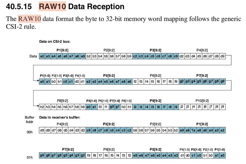

1.How the RAW10 format is arranged in buffer?
1.what is the default mipi clock in imx8m and how to change the mipi clock?
2.Did i miss anything to add in kernel to enable raw10 support?

1. I referred the mentioned Document and it says that, the IMX8M supports RAW format. and IMX8MDQLQRM document mentioned the IMX8M supports the RAW10 format.
Can you please explain how the RAW10 data is arranged in Buffer. I attached the screenshot from IMX6 datasheet for RAW10 data arrangements.
2. Yes, I talked about MIPI-CSI host clock the IMX8M supports 1.5GB per lane so what is the default operating clock? Because i received very low frame rate.
Questions
1. The RAW10 data arrangement for IMX6 & IMX8 is same or not?
2. What is the default mipi csi host clock and how can i increase the MIPI CSI host clock?

Supported cameras and formats are described in AN12187 Quick Start Guide
for MINISASTOCSI for i.MX 8M Evaluation Kit
https://www.nxp.com/docs/en/application-note/AN12187.pdf
Unfortunately porting raw sensor doc guide on imx8 currently not available, sorry.
The clocks are MIPI CSI host clocks, they are not related to external camera inpu signal.
The host can support 1, 2,3 and 4 lanes camera, so 1 lane camera can be supported. The lane number is set from device tree, "data-lanes = <1 2>;" means 2 lanes are used:
