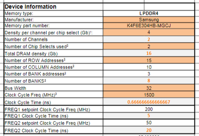

I'm trying to bring support to samsung's K4F6E304HB-MGCJ lpddr support to my imx8mm based board.
I've used  MX8M_Mini_LPDDR4_RPA_v20.xlsx to generate DDR script (.ds) file, when this file is loaded in MSCALE tool, the calibration is getting failed.
The configurations are correct!
Can you please say whether the configurations are correct or is there anything else to be added to the .ds file?
Attaching the file generated along with the RPA sheet

Could you share us the datasheet of samsung's K4F6E304HB-MGCJ you choose?
