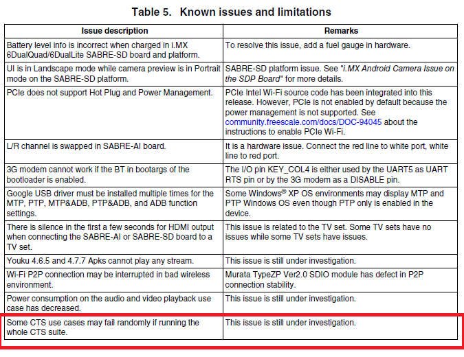

Hi ,
We have a CTS Test failed (android.keystore.cts.KeyChainTest - testIsBoundKeyAlgorithm_RequiredAlgorithmsSupported )  on our  custom project .
We verify the same CTS  Test on  EV board  - " IMX6 Series SABRE for Smart Devices" and get the same problems!
Is the CTS failed Known issues  ?
Can anyone Know how to solve this problems or any suggestion?
Test Enviroment :
CTS 5.1_r5
Freescale :
Image: Android 5.1.1 . I.MX6 DualLite (download from NXP i.MX 6 Series Software and Development Tool Resource)
CPU : iMX6DL
EVB version : IMX6 Series SABRE for Smart Devices (detail info)
MFG too: L5.1.1
The following are failed log on IMX6 Series SABRE for Smart Devices:
Compatibility Test Package: android.keystore ABI: armeabi-v7a
Test
Result
Details
  1. android.keystore.cts.KeyChainTest
-- testIsBoundKeyAlgorithm_RequiredAlgorithmsSupported
fail
  1. junit.framework.AssertionFailedError: RSA must be hardware-backed by a hardware-specific Keymaster HAL
Detaild Log :

Dear Artur,
I've  check the Table 5 of the attch doc, the table only show "Some CTS use cases may fail randomly if running the whole CTS suite."
Could you please provide the detail CTS errata list .
Many Thanks,
shuyu
3,385 Views
art
As the Table 5 says, the CTS use cases fail is random. So, there is no definite errata list for this issue.
Artur
3,383 Views
art
Please refer to the bottom row of the Table 5 in the attached document. It says that this is the known issue, but it was still under investigation at the moment of Lollipop 5.1.1 release. Now it seems to be fixed in the latest Marshmallow 6.0.1 release.
Artur
