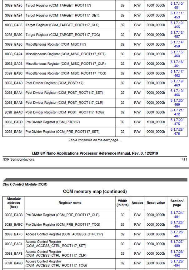

1. Through CCM Mem Map Regs
CCM_CLKO locates in Slice 116/117 and can be accessed through CCM Mem Map Regs

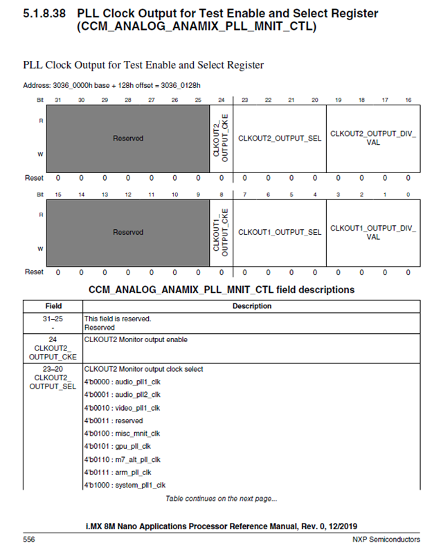

2. Through CCM Analog Mem Map Regs
Which one should be use or what are the differences between these two register sets?

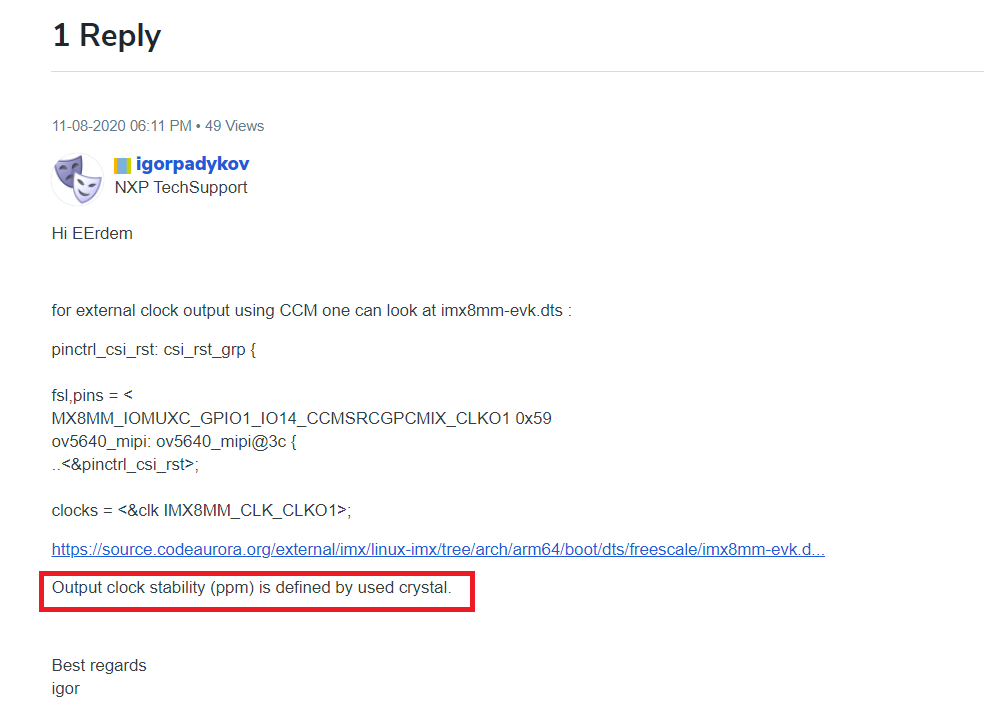

In this post https://community.nxp.com/t5/i-MX-Processors/i-MX8MM-CCM-OUTPUT/td-p/1179744
Igor wrote that the stability is defined by the used crystal and it seems this CCM_CLKO can serve as a CLK source feeding other peripherals.

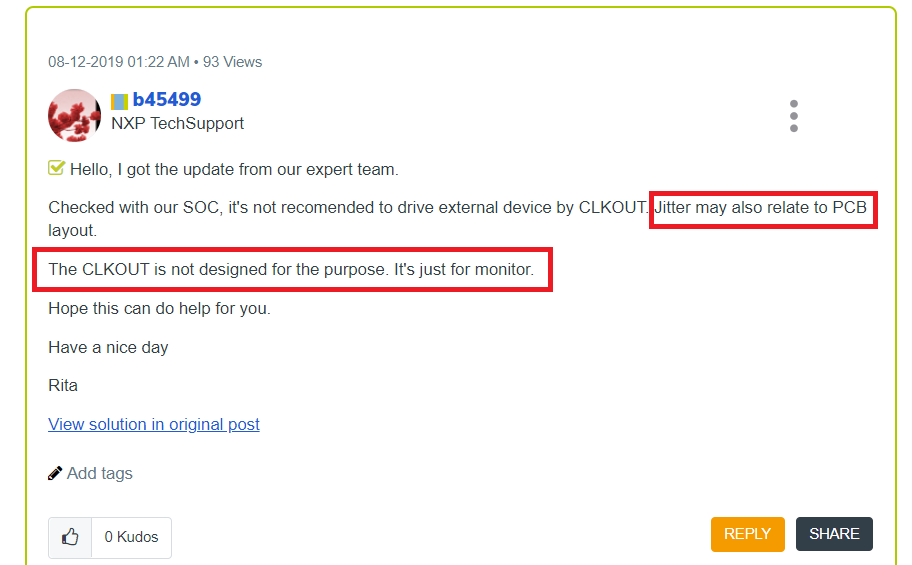

But in other posts,
https://community.nxp.com/t5/i-MX-Processors/CCM-CLKO-as-CLK-input-for-peripheral/m-p/971263
https://community.nxp.com/t5/i-MX-Processors/i-MX8M-Mini-definition-of-CCM-CLKO-2-1-pins/m-p/966969
guys were saying that CCM_CLO is just for monitor use.
CCM_ANALOG_ANAMIX_PLL_MNIT_CTL should be used.

this depends on requirements of connected peripherals, strictly speaking CCM_CLKO was
not characterized for frequency stability and can not be used for very stable clock.
For example CLKO1 is used for camera on J802 connector p.11 SPF-31407 i.MX8M Nano Baseboard schematic
Design Files for the i.MX 8M Nano Evaluation Kit (8MNANOD4-EVK)
