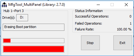

I have a board based on the mx6ullevk with the nand flash in place of the spi.  I have the nand image which can be downloaded with the mfgtool.  When I download that image it works.  I've changed the imx6ull14x14evk.conf to be nand for the UBOOT_CONFIG and I've built the u-boot-imx recipe using bitbake u-boot-imx.  A u-boot image is created, and works from the serial shell.  But when I use the mfgtool to program the board I get an error loading the rootfs.  When I go back to the original u-boot image the rootfs loads correctly.
Obviously I've not made all the changes necessary to build the nand flash version of u-boot.  What are the other changes I need to make?  I've found links to how to build for the nand flash, but all the information is old and predates the current included support.

I've been trying to figure out why what I compiled didn't work.  Each time I get this error when using the mfgtools2.
I finally downloaded the mfgtools2 version L4.9.88_2.0.0_mfg-tool which matches the code version I am using and I get the same error as the compiled code.  By luck I had downloaded the version L4.1.15_2.0.0-ga_mfg-tools originally which works.  I couldn't figure out why the compiled code failed.  Now I see that the compiled files supplied by NXP also fails to work on the mx6ull_14x14_evk_nand board.  Please figure out why these are broken and patch them.  I'll try to get back to the old version, as I need to progress in this project.

I followed the instructions on that page, but they seem to be years old.  I get an error compiling with those files:

These files seem wrong since there are now exists configs/mx6ull_14x14_evk_nand_defconfig and these old instructions contain configs/mx6ul_14x14_evk_nand_defconfig.  I do have the mx6ull_14x14_evk modified with nand.  It does work with the image that is stored with the mfgtool.  I would like to replicate compiling that image.  I seem to get close when I just changed local.conf to include both the following lines.
UBOOT_CONFIG = "nand"
CONFIG_CMD_NAND = "1"
I seem to be off in just the u-boot args.
