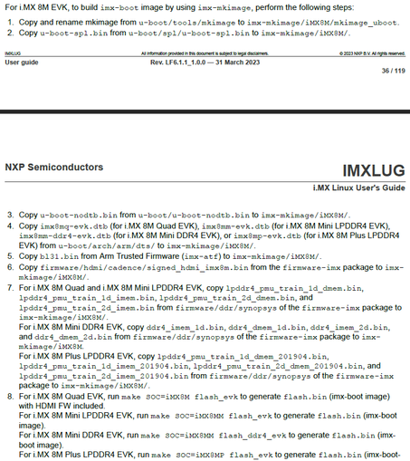

There's something to correct, based on i.MX Porting Guide:
The System Controller is supported through a firmware also known as SCFW flashed into the boot image on
SoC in the i.MX 8 and i.MX 8X families. (Not 8M family)
and i.MX Linux Users Guide, comparing a 8MP die vs 8DXL die:
We can tell that MP option doesn't exist because it isn't needed.
