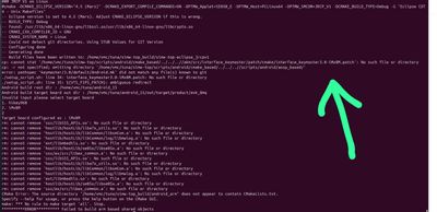

Hi everyone,
I am trying to build the Plug & Trust Middleware for the SE050 on the i.MX8 using the Android development platform. The issue I’m facing is that during the build process, the file path for interface_keymaster3.0-iMx8M.patch cannot be found. I have tried searching for this file within the Plug & Trust Middleware folder but couldn't locate it. Has anyone ever built the SE050 library on the Android platform and could offer some advice on how to successfully build it?

Bio_TICFSL
This is Android/Android Auto platform, based on Google’s design, integrates the Keymaster HAL, Gatekeeper HAL, and Secure Storage proxy.
Keymaster HAL uses trusty-backed one and supports Keymaster V2 and Keymaster V3 APIs. For more details about keymaster, see https://source.android.com/security/keystore
This file should include in Android BSP, please download correctly or download the BSP from NXP.

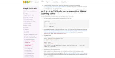

WhatsApp Image 2025-08-01 at 16.09.19.jpegWhatsApp Image 2025-08-01 at 16.09.19.jpeg
Hello Bio,
As soon as, i try to step by step as Plug & Trust Middleware for the SE050 Guide. But i can see as.
