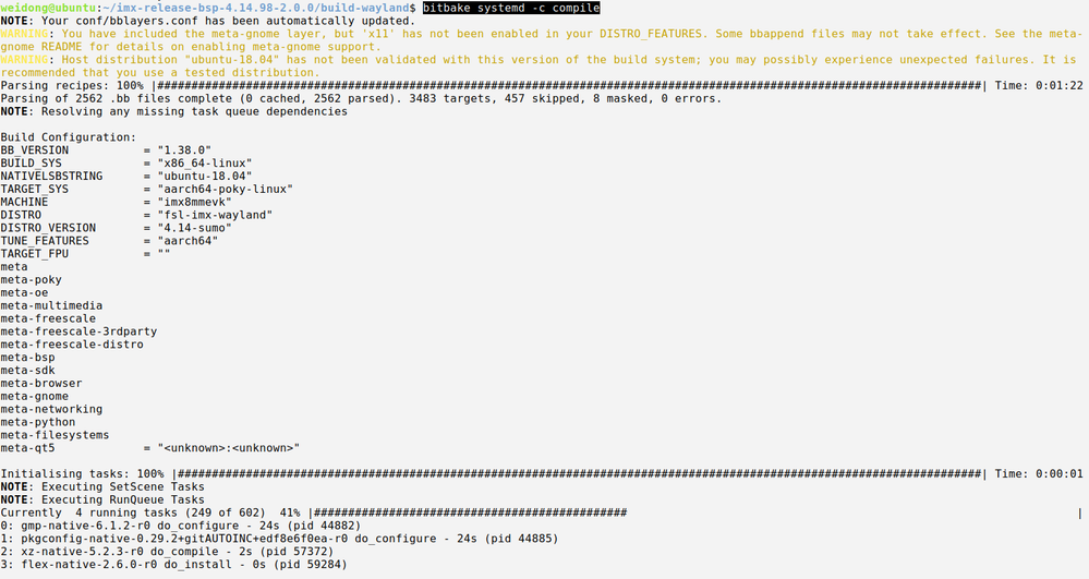

Hi  Sreedhar A,
  See below, please!
1. test result.
#DISTRO=fsl-imx-wayland MACHINE=imx8mmevk source fsl-setup-release.sh -b build-wayland
#bitbake systemd -c compile
So no probem.
2. About your issues.
It seems that systemd package or dependencies is not complete. so configure failed.
you can clean its packages or states, then recompile it.
# bitbake systemd -c cleanall
# bitbake systemd -c compile
Have a nice day!
