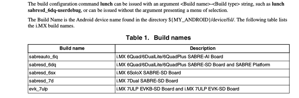

Hi Yen Chou,
It seems like you are building for i.MX 6Quad/6DualLite/6QuadPlus SABRE-AI Board. You can refer Table 1. Build names from Android User's Guide for android device name.
Please try once to build with the below steps:
         $ cd ${MY_ANDROID}
         $ source build/envsetup.sh
         $ lunch sabreauto_6q-userdebug
         $ make bootimage
Radhika Somaiya.
12,923 Views
yenchou
Hi Radhika,
Thank you for your quick reply.
Sorry, I copied the wrong words, the correct words is "lunch sabresd_6dq-userdebug".
I want to build  image for imx6 DualLite SABRE-SD board.
Now I have to copy .config and zconf.lex.c files to out/target/product/sabresd_6dq/obj/KERNEL_OBJ.
But I think the method is not regular, I have to find other method.
Many thanks,
Yen Chou.
