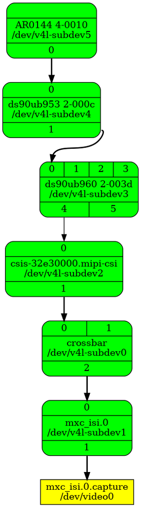

I am using an imx8mn board in which i have the attached CSI pipeline configured.
I have enabled pattern in ar0144 image sensor and configured the deserializer and serializer appropriately.
I configure the route and formats with the below commands.
media-ctl -d /dev/media0 --link '"ds90ub960 2-003d":4 -> "csis-32e30000.mipi-csi":0 [1]' && media-ctl -V '"csis-32e30000.mipi-csi":0 [SBGGR12_1X12/1280x800 field:none]' && media-ctl -V '"csis-32e30000.mipi-csi":1 [SBGGR12_1X12/1280x800 field:none]' && media-ctl -V '"crossbar":2 [SBGGR12_1X12/1280x800 field:none]' && media-ctl -V '"crossbar":0 [SBGGR12_1X12/1280x800 field:none]' && media-ctl -V '"mxc_isi.0":1 [SBGGR12_1X12/1280x800 field:none]' && media-ctl -V '"ds90ub953 2-000c":1 [SBGGR12_1X12/1280x800 field:none]' && media-ctl -V '"ds90ub960 2-003d":0 [SBGGR12_1X12/1280x800 field:none]' && media-ctl -V '"ds90ub960 2-003d":4 [SBGGR12_1X12/1280x800 field:none]' && media-ctl -V '"AR0144 4-0010":0 [SBGGR12_1X12/1280x800 field:none]'

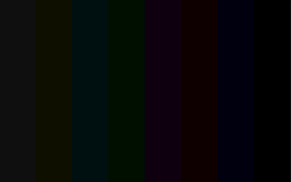

But the image that was captured has a very low brightness.
1. The sensor output has been validated, and I am generating a valid test pattern directly from the sensor.
2. I have tried to disable the test pattern and tried to capture a live image. That too has the same brightness issue.
3. The image captured has a size of 2048000. However, upon analyzing the raw data, the maximum pixel value observed is 255. Does this indicate that the data is truncated to 8 bit somewhere in the pipeline?

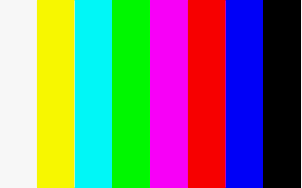

Making the below change fixed the issue.
.mbus_code = MEDIA_BUS_FMT_SBGGR12_1X12,
.fourcc = V4L2_PIX_FMT_SBGGR12,
.type = MXC_ISI_VIDEO_CAP,
.isi_out_format = CHNL_IMG_CTRL_FORMAT_RAW12,
.mem_planes = 1,
.color_planes = 1,
.depth = { 16 },
.encoding = MXC_ISI_ENC_RAW,
In the 5.4 kernel version, I see that the value was RAW12. With 6.9 kernel version, this change was intriduced, along with the below comment.
* RAW formats
* The ISI shifts the 10-bit and 12-bit formats left by 6 and 4 bits
* when using CHNL_IMG_CTRL_FORMAT_RAW10 or MXC_ISI_OUT_FMT_RAW12
* respectively, to align the bits to the left and pad with zeros in
* the LSBs. The corresponding V4L2 formats are however right-aligned,
* we have to use CHNL_IMG_CTRL_FORMAT_RAW16 to avoid the left shift.
Any reason why this change was made?
Changing the format to raw12 shift the data by 4 bits and adds waste bit LSBs as per datasheet.
RAW12 - 12-bit RAW data packed into 16-bit DWORD with 4 LSBs waste bits

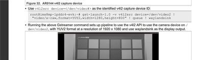

for imx8mp, ar0144 is used as monochrome sensor, and uses 8mplus isp directly and bypasses the oncamera isp,
and on 8mplus it does support yuy2 format,

I am trying to port the kernel version from 5.4 to 6.9, with which I noticed there are changes in the NXP drivers.
I set the format as SBGGR12_1X12.
With the 5.4 kernel version, I capture image from the image sensor and I see proper image captured.
On examining the raw image captured from 5.4 kernel version, I see the below value.
01f35f0 0000 0000 0000 0000 f700 f700 f700 f700
01f3600 f700 f700 f700 f700 f700 f700 f700 f700
01f3730 f700 f700 f700 f700 0000 f700 0000 f700
01f3740 0000 f700 0000 f700 0000 f700 0000 f700
01f3870 0000 f700 0000 f700 f700 f700 f700 f700
01f3880 f700 f700 f700 f700 f700 f700 f700 f700
But With 6.9 kernel version, the image looks very dark.
I see the hexdump of captured image (6.9 version) as below,
01f3730 0f70 0f70 0f70 0f70 0000 0f70 0000 0f70
01f3740 0000 0f70 0000 0f70 0000 0f70 0000 0f70
01f3870 0000 0f70 0000 0f70 0f70 0f70 0f70 0f70
01f3880 0f70 0f70 0f70 0f70 0f70 0f70 0f70 0f70
01f39b0 0f70 0f70 0f70 0f70 0000 0f70 0000 0f70
01f39c0 0000 0f70 0000 0f70 0000 0f70 0000 0f70
01f3af0 0000 0f70 0000 0f70 0f70 0000 0f70 0000
01f3b00 0f70 0000 0f70 0000 0f70 0000 0f70 0000
Is the pixel value not getting shifted by 4 bits in case of RAW12 format in 6.9 kernel version imx drivers?
