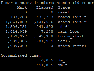

Dear all,
We are working on Android 9 Auto on I.MX8QM-MEK platform. We need to optimize boot time.
It will be grateful if anyone can throw some light here by proving some important patches, reference links etc. for this android version and platform.
We have already gone through  couple of below post :
Optimizing Boot Times  |  Android Open Source Project
https://community.nxp.com/thread/479381

One more doubt: We tried to optimize u-boot but it still takes ~2.59 sec to start the kernel. We have already removed unnecessary drivers and Logs. After looking more closely we see that there are some logs coming from tee.bin which is sitting inside /vendor/nxp-opensource/imx-mkimage. Can we remove these logs ?
Here are the current logs from u-boot with timestamp:
[0.000001 0.000001]
[0.959662 0.959661] BTO: U-Boot SPL 2018.03-00004-g69a33ef (Apr 01 2020 - 19:04:59 +0530)
[1.278124 0.318462] U
[1.294403 0.016279] welcome to lk/MP
[1.295475 0.001072]
[1.295542 0.000067] boot args 0x2000000 0xfe000000 0x2000 0x
[1.297647 0.002105] generic_arm64_map_regs: failed -5 name=gic
[1.312700 0.015053] initializing trusty (Built: :00:46 Mar 5 2019)
[1.315494 0.002794] Initializing Trusted OS SMC handler
[1.317379 0.001885] int build_hset_all(struct uctx *):238: Rebuilding all handles set
[1.326491 0.009112] hwcrypto: 222: Initializing
[1.328177 0.001686] hwrng_caam: 44: Init HWRNG rvice provider
[1.330215 0.002038] hwrng_srv: 256: Start HWRNG service
[1.332220 0.002005] int rebui_hset_all(struct uctx *):238: Rebuilding all handles set
[1.342303 0.010083] hwcrypto_caam: 78: Init HWCRYPTO service provider
[1.344947 0.002644] hwcrypto_v: 306: Start HWCRYPTO service
[1.349575 0.004628] hwkey_caam: 169: Init HWKEY seice provider
[1.358296 0.008721] hwkey_caam: 138: Invalid magic
[1.363949 0.005653] hwkey_srv: 331: Start HWKEY service
[1.370600 0.006651] hwcrypto: 237: enter main event loo
[1.376187 0.005587] int rebuild_hset_all(struct uctx *):238: Rebuilding all handl set
[1.381949 0.005762] int rebuild_hset_all(struct uctx *):238: Rebuilding all handles set
[1.383734 0.001785] int rebuild_hset_all(struct uctx *):238: Reilding all handles set
[2.110303 0.726569] ss: get_rpmb_auth_key: failed to get key: -2
[2.128344 0.018041] ss: proxy_connect: can't t storage auth key: (-2)
[2.134139 0.005795] ipc: do_connect: failure initializinchannel state (1001)
[2.158401 0.024262] Fastboot: Normal
[2.159615 0.001214]
[2.593082 0.433467]
[2.593327 0.000245] Starting kernel ...
How can we further optimize u-boot ?
