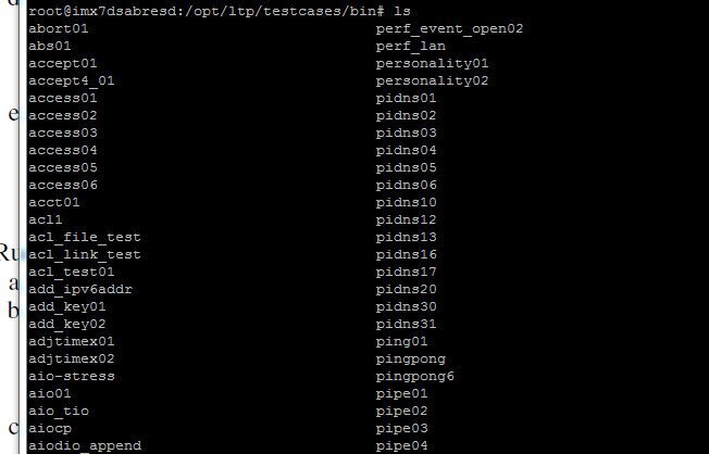

chandiniindavar
Test utilities don’t seem relevant:

chandiniindavar
any idea what pingpong does which is under  /opt/ltp/testcases /bin ?
