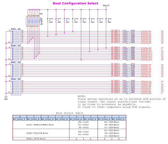

Hi Igor,
Thank you for pointing me those resource, I will try to dig it one-by-one. I found this boot configuration select, but looks like this schematic is different with mine (not sure, though). Because my board's (Hobbit Board of POSLAB) DIP switch has 6 switches, but this one has 8 switches. I'm new to this, so any help I really appreciate it.

igorpadykov
Hi Lufi
one can look at nxp bsps and documentation
https://www.nxp.com/support/developer-resources/run-time-software/i.mx-developer-resources/i.mx-6ser...
If schematic is available one can port it using Porting Guide inlcuded in linux documentation on above link.
i.MX6 Sabre SD Schematics :
i.MX6_SABRE_SDP_DESIGNFILES
http://www.nxp.com/products/software-and-tools/hardware-development-tools/sabre-development-system/s...
