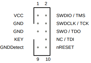

After first Power On, can we use the JTAG Port or Serial Wire Debug Interface for loading the Program Image into the On-Chip memory?

3. Yes, you can load Program image by HW debugger.
