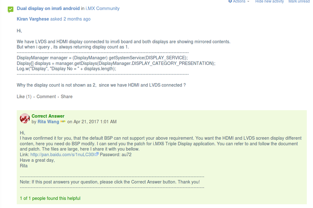

Hi Rita,
It seems i have received this patch as part of displaying different content on dual display issue.
Please refer - https://community.nxp.com/thread/449536
I did applied this patch and still observing HDMI display showing contents late at boot.
Could you please confirm its the same patch or its having fix for both HDMI and LVDS showing contents from boot.

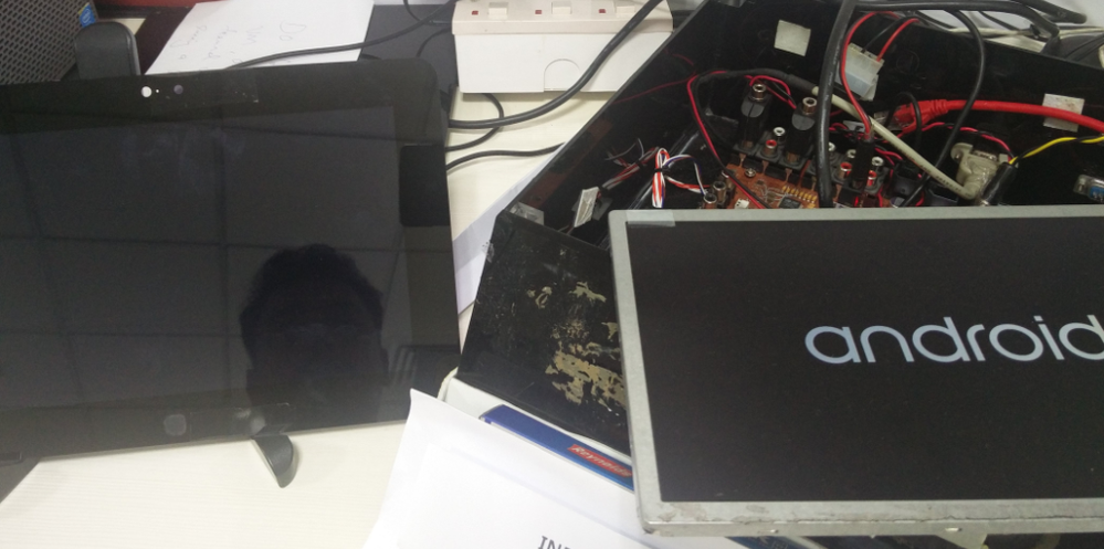

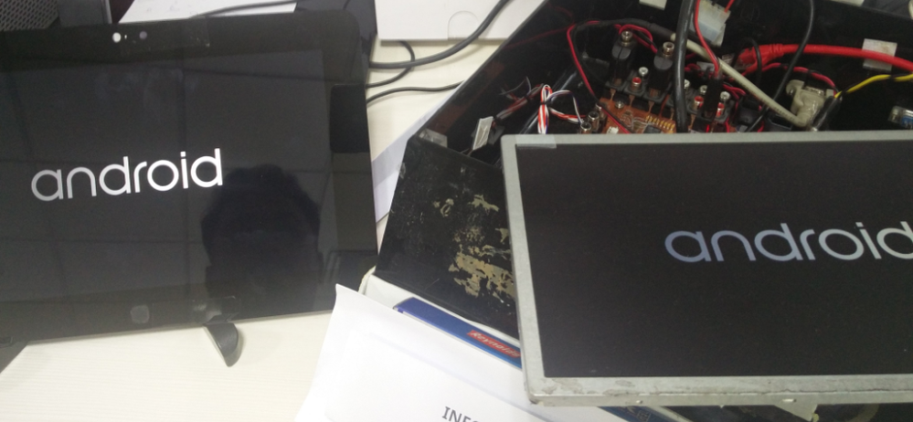

My Issue :
After booting only LVDS display(on the right) showing contents :
HDMI display (on the left) starts showing contents after 34 seconds from boot :
