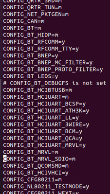

Hi , we are developing a custom firmware for imx8mp with 6.1.36 kernl
we tried to bringup bluetooth interface in evk and met with a error
root@imx8mp-lpddr4-evk:~# dmesg | grep -i bluetooth

root@imx8mp-lpddr4-evk:~# bluetoothctl
Agent registered
[bluetooth]# power on
No default controller available
root@imx8mp-lpddr4-evk:~# hciattach /dev/ttymxc2 qca
qca
frame_hci_cmd_pkt: Sending EDL_PATCH_VER_REQ_CMD
HCI-CMD -1: 0x1 0x0 0xfc 0x1 0x19
read_vs_hci_event: Wait for HCI-Vendor Specfic Event from SOC
wait_for_data: Timing out on select for 3 secs.
hci_send_vs_cmd: Failed to get HCI-VS Event from SOC
Failed to attach the patch payload to the Controller!
qca_soc_init: Fail to get Rome Version (0xffffff92)
Initialization timed out.
root@imx8mp-lpddr4-evk:~# hciconfig hci0 up
Can't get device info: No such device

Hi @A_M01
you need to load the WIFI firmware first, use this command "modprobe moal mod_para=nxp/wifi_mod_para.conf"
Then Load BT firmware and enable BT:
root@imx8mp-lpddr4-evk:~# modprobe btnxpuart

A_M01
I am using custom board and uart1 is up at node ttymxc0
Checked for loopback and its there
Iam not able to load the firmware ,
Brcm_patchram_plus -d --enable_hci --no2bytes --tosleep --baudrate 115200 --patchram /etc/firmware/BCM4345C5_003.006.006.1021.1045_CL2.hcd /dev/ttymxc0
I checked while probing the communincation was not present
3,516 Views
A_M01
hciattach ttymxc2 any 115200 flow
[ 120.385606] Bluetooth: hci0: command 0x1003 tx timeout
[ 120.385619] Bluetooth: hci0: Opcode 0x1003 failed: -110
Can't init device hci0: Connection timed out (110)
