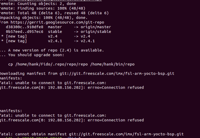

   we try to download the 3.14.52 BSP, but we got connection refused. How to fix this issue?
   thanks.
   The command is below:
   repo init -u git://git.freescale.com/imx/fsl-arm-yocto-bsp.git -b imx-3.14.52-1.1.0_ga

the source code was moved to "https://source.codeaurora.org/external/imx", try to change the ""git://git.freescale.com/imx" " to "https://source.codeaurora.org/external/imx"
