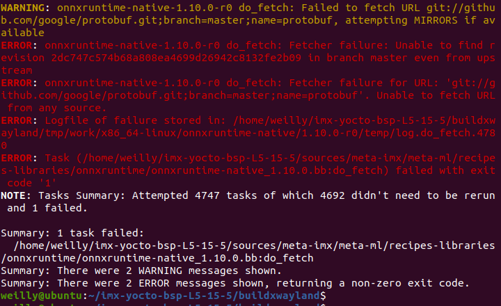

weilly_li
Hi, @Zhiming_Liu
        Now,  I have a troblem about ONNXRuntime do_fetch Issue.
        Please tell me what's next ? I will apprecitate you !! thank you
20,319 Views
HME15769
protobuf git link is incorrect in the 2nd error line. "master" branch is not exist in protobuf repository.
https://community.nxp.com/t5/i-MX-Processors/Build-of-onxxruntime-native-in-imx-image-full-for-IMX8M...
20,305 Views
weilly_li
. Hi, @HME15769
      that's very power information !!  I fetched successfully onnxruntime !!
      thank you so much !!
