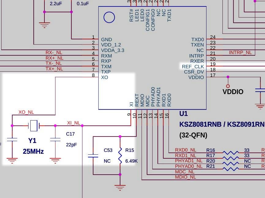

I'm using imx8mm (PICO PI imx8mm) on my own board. My PHY is KSZ8091, which works in RMII standard.
PHY generates 50Mhz clock on its ref_clk (by doubling 25Mhz clock from its XO pin I guess) pin:

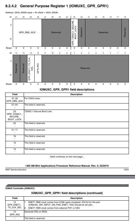

This is what I have currently, and it seems to work. But I'm not convinced this is the right way, for starters, as you can see, there's not even a mention of
MX8MM_IOMUXC_ENET_TD2_ENET1_TX_CLK
Even though the pin, (AG25/ENET_TD2) corresponding to this function, physically connects from MAC side to REF_CLK pin at PHY.
I don't know where is written how MAC side is supposed to receive or send 50Mhz clock in RMII mode, which makes MAC "understand" that TD2 (AG25/ENET_TD2) function is where clock is for RMII, without proper pad configuration in the above mentioned device tree file. If it's "u-boot/u-boot-tn-imx/arch/arm/dts/imx8mm-ddr3l-val.dts", how does it being loaded? How does OS know to load this particular device tree file?
Looking at processor manual and by looking at suggestions in this forum, there seems to be IOMUXC_GPR_GPR1 register which has a relevant field called: "GPR_ENET1_TX_CLK_SEL"
I need it to be set to value 0, because RMII clock comes from "external" PHY.
Where do I set this value? In imx6, here, a guy edited mach-imx6ul.c, namely:
        regmap_update_bits(gpr, IOMUXC_GPR1, IMX6UL_GPR1_ENET2_CLK_DIR,
                   0);
        regmap_update_bits(gpr, IOMUXC_GPR1, IMX6UL_GPR1_ENET2_CLOCK_SEL_MASK,
                   1);
 But I have imx8mm, and I couldn't find a relevant file, where is it? Do I make a similar edit?
