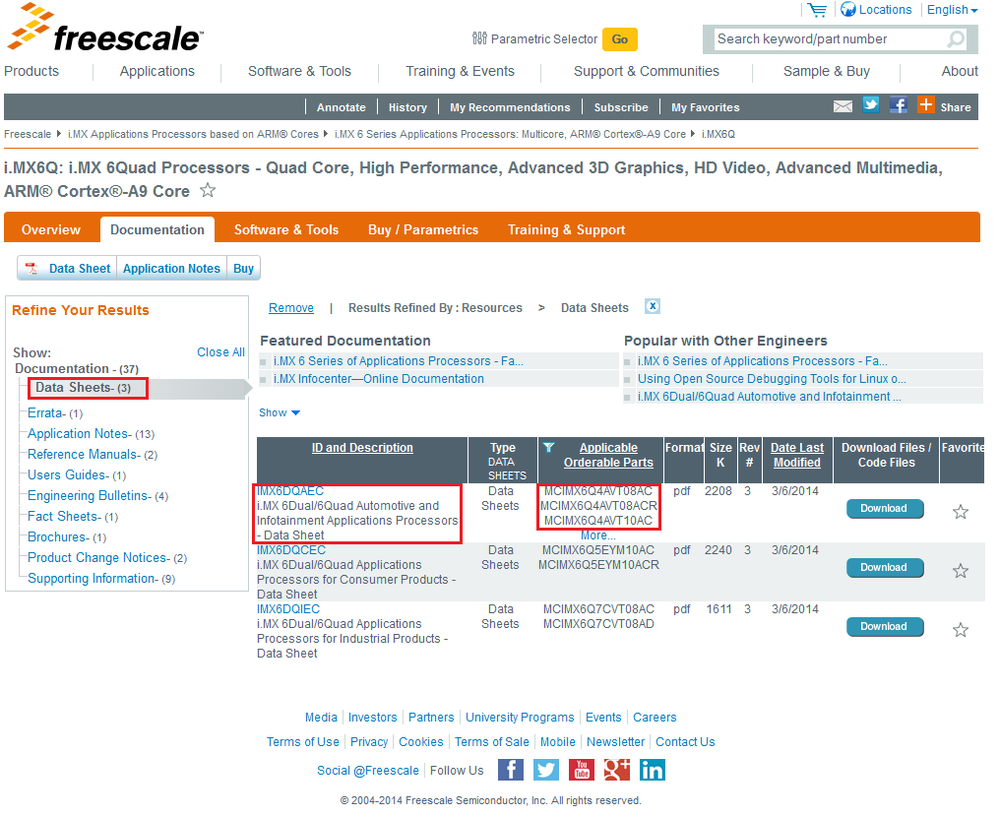

If you require automotive qualified parts, please ensure that you select the automotive part numbers.
For example searching on the i.MX6Q documentation, going to Data Sheets, the automotive document is “i.MX 6Dual/6Quad Automotive and Infotainment Applications Processors - Data Sheet” (IMX6DQAEC):
Hope this will be useful for you.
